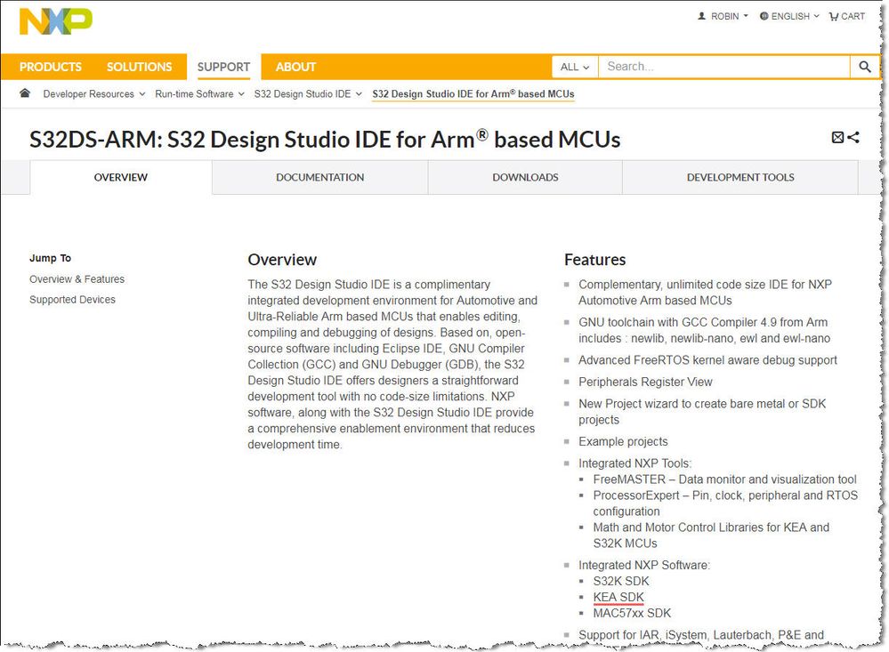

      Hi sir,i‘m using KinetisEA Series MCUs development boards,but i haven't found the right Kinetis SDK for Kinetis Design Studio Integrated Development Environment. I want to know when the Kinetis SDK of Kinetis EA series is released and please send it to me if it has been released. Thank you very much.
748 Views
Robin_Shen
Hi Lizz,
The SDK for KEA is Integrated in S32DS-ARM: S32 Design Studio IDE for Arm based MCUs.
