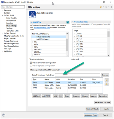

Erich, any tips on getting the  MCU-Link from NXP to work on more micros?
I tried to get it setup for the K32L2A following a couple of your article posts for the LPC845 on the MCU-Link.
I don't recall the exact error I was getting right now, something along the lines the wrong Flash algorithm was being used.  I could not find documentation on some of the settings so was guessing at many of them.

Hi @bobpaddock ,
I have not used that K32L2A, but I see that it is supported by the NXP MCUXpresso SDK. So it should be just a matter of downloading that SDK, create a project in the MCUXpresso IDE and then everything should be set up correctly (I assume) including the correct flash algo for it?
The critical setting is here: based on the selected MCU it shall use the default internal driver or list the flash driver there:
Erich
