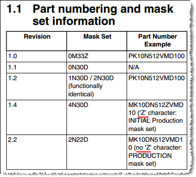

I used MK60DN512ZVLQ10 and KSDK 2.0.0
There are some problems with this code.
When I debug to "MCG_C7_OSCSEL_VAL",the mcu will run to "HardFault_Handler".
What should I do?

Robin_Shen
The KSDK2.0 doesn't support MK60DN512ZVLQ10.
According to Kinetis K 100MHz Rev 1.x to Rev 2.x Migration Guide, MK60DN512ZVLQ10 belong to Rev 1.x.

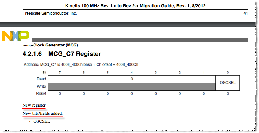

Since your MCU doesn't have MCG_C7 Register, it will run to "HardFault_Handler".
