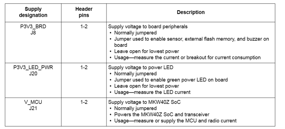

When I connect FRDM -KW40Z to PC it doesn't turn on (no LED turns ON). How to check what is the problem?

I just downloaded new bootloader Firmware to my FRDM-KW40Z board and the board now appears dead, it did flash LEDs before I copied the new firmware.
The Firmware I donloaded was k20dx128_frdm_kw40z_cmsis-dap.bin from http://cache.nxp.com/files/32bit/software/k20dx128_frdm_kw40z_cmsis-dap.bin
How can I recover my board?

Please check if the dip is on the correct position:
