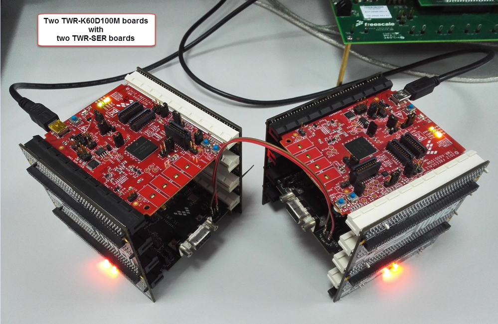

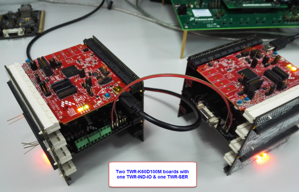

Hui_Ma
Hi Yaran,
For I have only one TWR-IND-IO board on my hand, I had test two case: 1> two TWR-K60D100M boards with two TWR-SER boards 2> two TWR-K60D100M boards with one TWR-IND-IO and one TWR-SER boards. Both cases can works with <flexcan_uart> demo within Kinetis SDK V1.1.0.
Please check my attached pictures about boards connections.

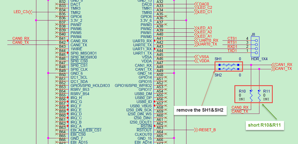

Customer should short TWR-IND-IO board jumper J13 to provide CAN bus feedback resistor.
And customer need do below modification at TWR-IND-IO board:
Wish it helps.
