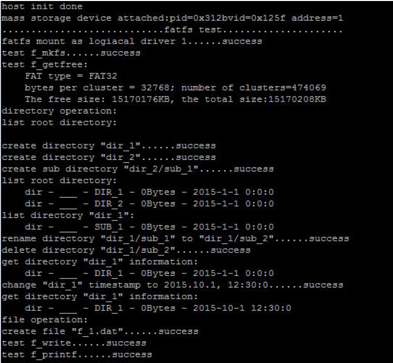

What would be the normal response from frdmk 64f_host_msd_fatfs_bm during a debug session ?
My telnet session is getting rejected.
678 Views
danielchen
Plug in a u-disk device to the board, the attached information prints out in the terminal
Please refer to the attached  readme file
679 Views
randyseedle
Should this application work with an SDIO card ? Is there a better application to work with SDIO cards ?
679 Views
danielchen
This example only supports UFI ans SCSI U-disk device.
