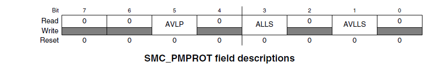

New discovery. I tried the following code:
  SMC->PMPROT = SMC_PMPROT_AHSRUN_MASK; // Allow highspeed run mode
  SMC->PMCTRL &= ~SMC_PMCTRL_RUNM_MASK; // Clear the [RUNM] field
  SMC->PMCTRL |= SMC_PMCTRL_RUNM(0x80U); //Set [RUNM] field
  if( (SMC->PMCTRL &SMC_PMCTRL_RUNM_MASK) == SMC_PMCTRL_RUNM(0x80U)){
      if( SMC->PMPROT & SMC_PMPROT_AHSRUN_MASK){
      while(3);
      }else{
      while(4);
  }else{
      while(2);
And it stops in while(4). So the PMPROT register is not(!) writeable. How can that be?
The datasheet says: "The PMPROT register can be written only once after any system reset."
Yes, above is my first write. But anyhow it does not seem to work.

charlesasquith
I believe that your problem might be with the line enabling HSRUN mode. I just tested this code, and it works. Give it a try?
    SMC->PMPROT |= SMC_PMPROT_AHSRUN_MASK;     // Allow highspeed run mode
    SMC->PMCTRL |= SMC_PMCTRL_RUNM(HSRUN_MODE);     //Set [RUNM] field
    while(SMC->PMSTAT != HSRUN_MODE){/* do nothing */}     //Wait for HSRUN Mode to be achieved
**Note that HSRUN_MODE is defined as 0x80U, just as you have it.
Also, if you're entering HSRUN_MODE so that you can run at higher clock speeds, make sure that you increase the clock speeds to your desired values only AFTER you have achieved HSRUN mode, not before.
