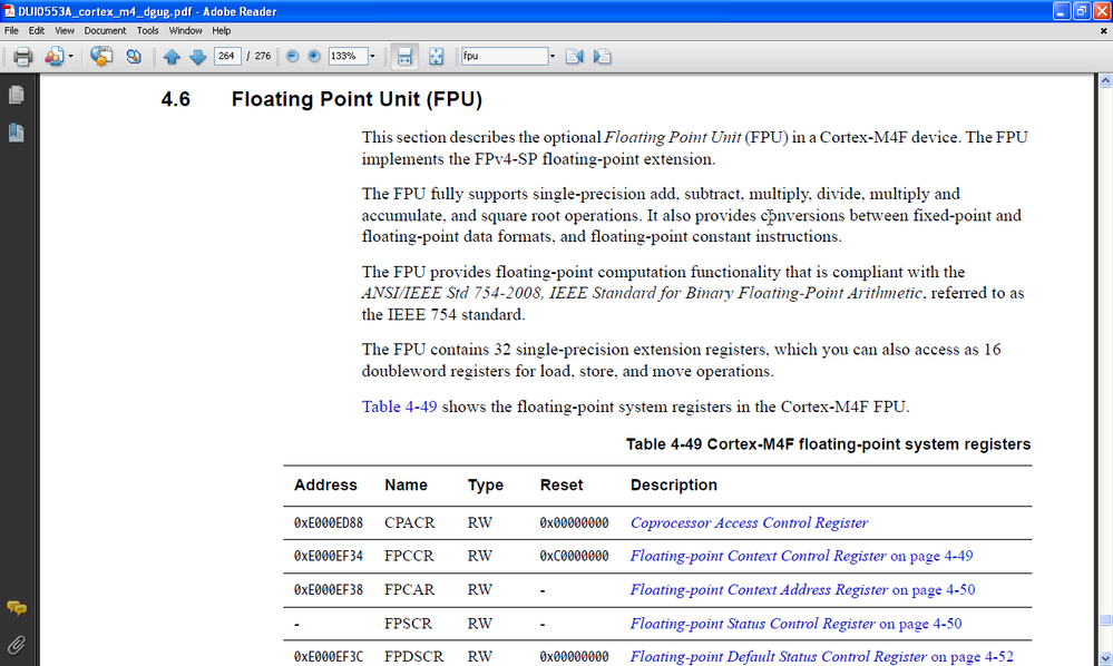

What register should be configured before useage the FPU in MK60FX512VLQ15? Thanks.

Access to the FPU is enabled with CPACR |= (0xf << 20);

Sorry, I don't find this register named CPACR in header file.Could you tell me in detail ?

Hi 朱葛峻,
I think Mark mean the following register, you may refer to http://infocenter.arm.com/help/topic/com.arm.doc.dui0553a/DUI0553A_cortex_m4_dgug.pdf for more details.
