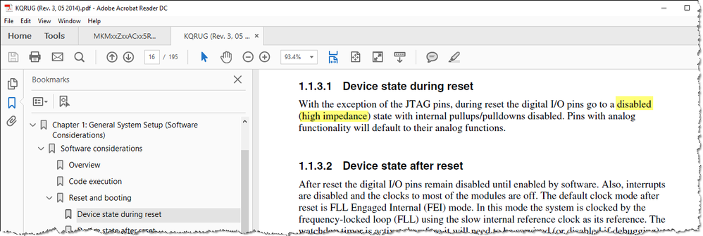

In the manual "Document Number: MKMxxZxxACxx5RM Rev. 1, 09/2014"
Referring to "10.2 Photon Signal Multiplexing and Pin Assignments"
No. 44 pin of 44 LGA type is disabled at DEFAULT.
I will use this as PTF 1, but here is the question.
① In the case of DEFAULT = disable after reset, what is the direction of input / output in what state?
② I think that it is not pulled up and pulled down, is it correct?

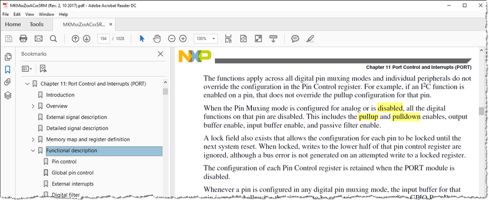

Looking at "11.5.1 Pin Control Register n (PORTx_PCRn)" in the manual
Pull Enable and Pull Select,
"Varies by port. See Signal Multiplexing and Signal Descriptions chapter for reset values per port."
Although it is written, I do not understand even if I look at the reference destination.

Hi jun yamada,
Please check the description in Kinetis Peripheral Module Quick Reference and MKMXXZXXACXX5RM:
①DEFAULT = disable = high impedance
②not pulled up and pulled down
Robin
