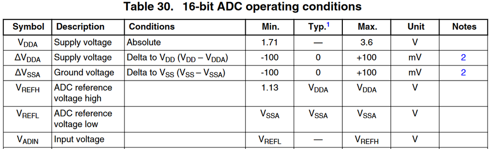

What is the input voltage range of ADC on MK64FN1M0VDC12?

Hi JiHoo
The input voltage of the analog-to-digital converter is specified in the  Kinetis K64F Sub-Family DataSheet. It's possible to find  this characteristic in chapter 3.6.1 on the table 30 of this document, as it is shown below.
The Input voltage (VADIN) accepts values between the ADC reference voltage low and high (VREFL and VREFH). This reference voltages depend on the value of the ground voltage (VSSA) and the supply voltage (VDDA).
Then, the  ADC input voltage range is 0 ±100mV  to 3.6V±100mV(depending on the supply voltage).
Please let me know if you need any more information.
