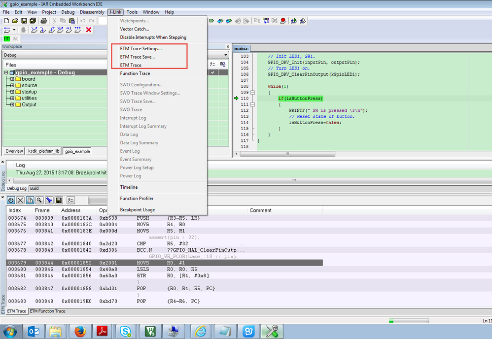

      ETB module in K64F is like the MTB module in KL25Z.
    About the ETB usage, actually in ARM's web, there has a document named as Embedded trace buffer reference manual for the detail ETB information, the document link is:
http://infocenter.arm.com/help/topic/com.arm.doc.ddi0242b/DDI0242.pdf
    You can refer to the document for more ETB knowledge.
    But now, about the ETB usage, we mainly use the debugger tool associate with the IDE to trace the code, for example, JLINK+IAR:
Wish it helps you!
