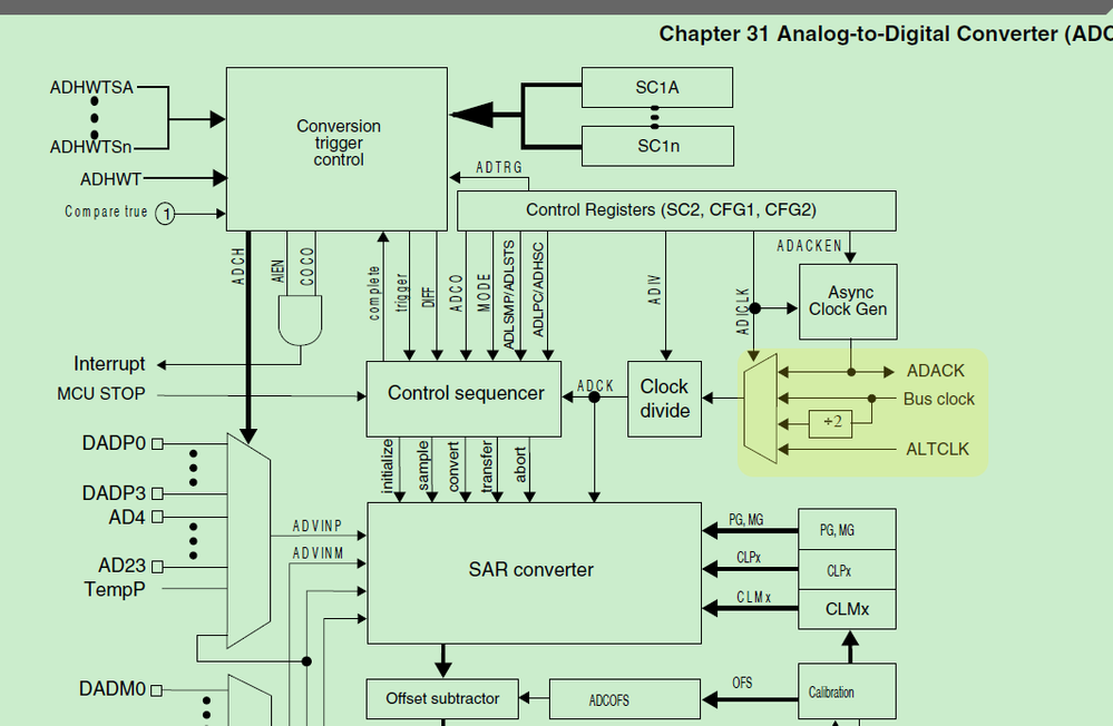

On the MK12DN512VLK5 Kinetis K12 part, what is the clock frequency range for the ADC. The reference manual mentions in couple of places that the ADC clock frequency should be in the specified range but I could not find the actual frequency specification.

Hi Deepak Kukreja,
  Which ADC clock source you are using now?
If you are using the ADACK, it is in the datasheet:
Kerry

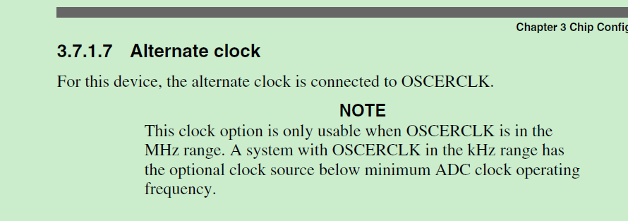

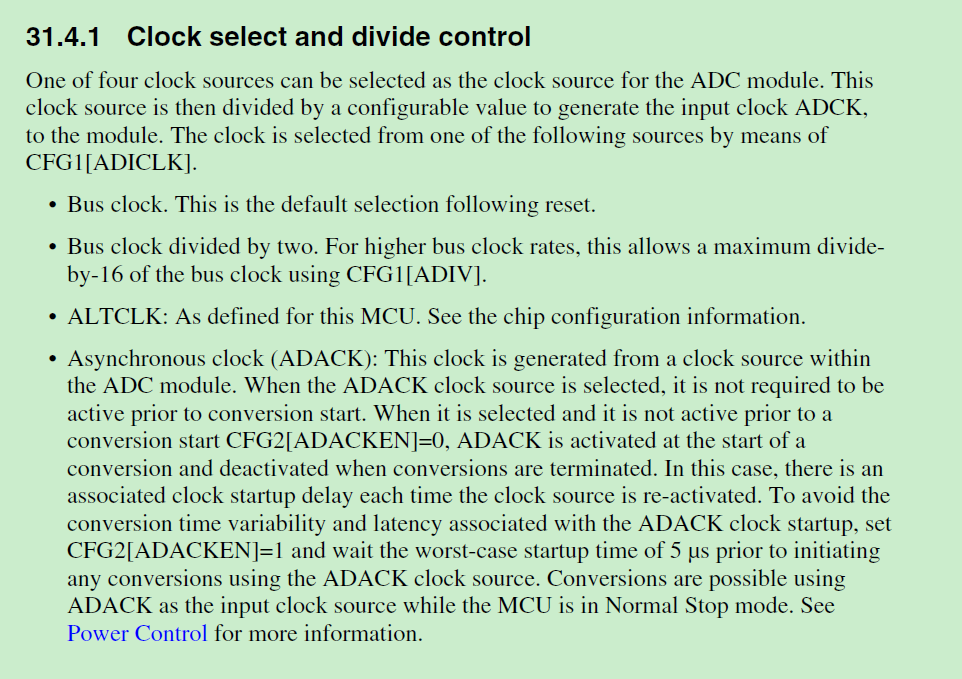

DeepakKukreja
Hi kerryzhou,
Thanks for sharing the relevant portions from the Reference Manual.
From the snapshots of the reference manual, does it imply that only the ADACK needs to meet the specifications, and there is no such restrictions in case bus clock is used as the input clock?
I am planning on using the bus clock, and will be trying with the below options:
Can you please validate my calculations below:
OPTION 1: Bus clock (48 MHz) with no divider, fastest conversion
ADCx_CFG1[ADICLK] set to 0(dec). Input clock set to bus clock
ADCx_CFG1[ADIV]   set to 0(dec). Divide ratio is 1
I assume ADCK gets set to 48 MHz
OPTION 2: Bus clock(48 MHz)/2 with max. divider, slowest conversion
ADCx_CFG1[ADICLK] set to 1(dec). Input clock set to bus clock/2
ADCx_CFG1[ADIV]   set to 3(dec). Divide ratio is set to 8
I assume ADCK gets set to 3 MHz

kerryzhou
Hi Deepak Kukreja ,
  Other clock, you need to meet the conversion clock requirement:
Any new questions, welcome to create the new question post.
