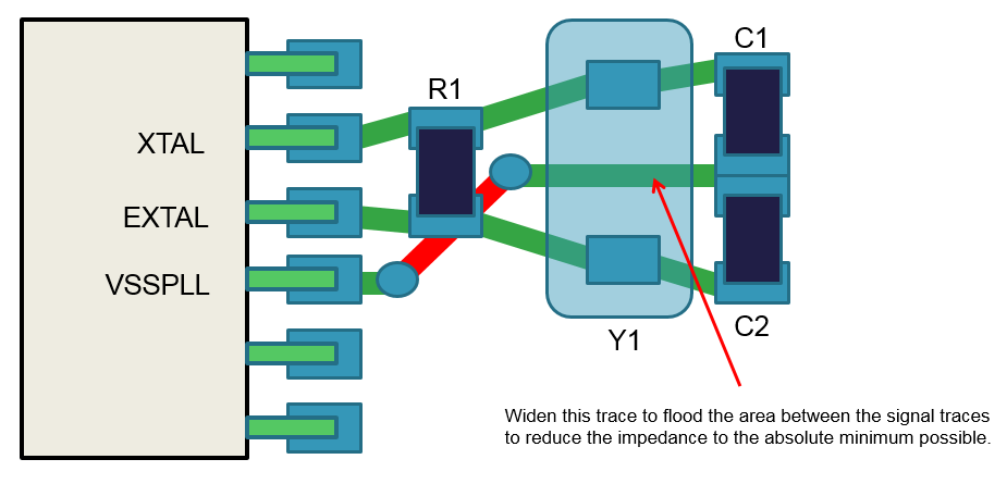

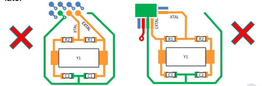

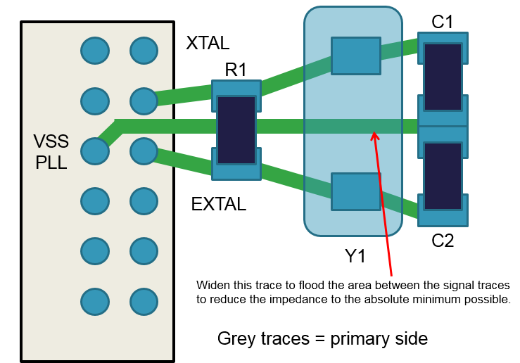

I checked the Layout doc file, I would recommend double check the crystal circuit to avoid another signal around the crystal circuit:
Please refer below crystal circuit layout design:

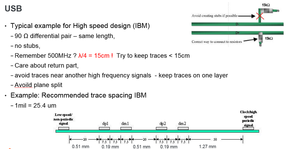

The USB circuit layout with below recommendation:
I checked the USB circuit layout without any problem.
