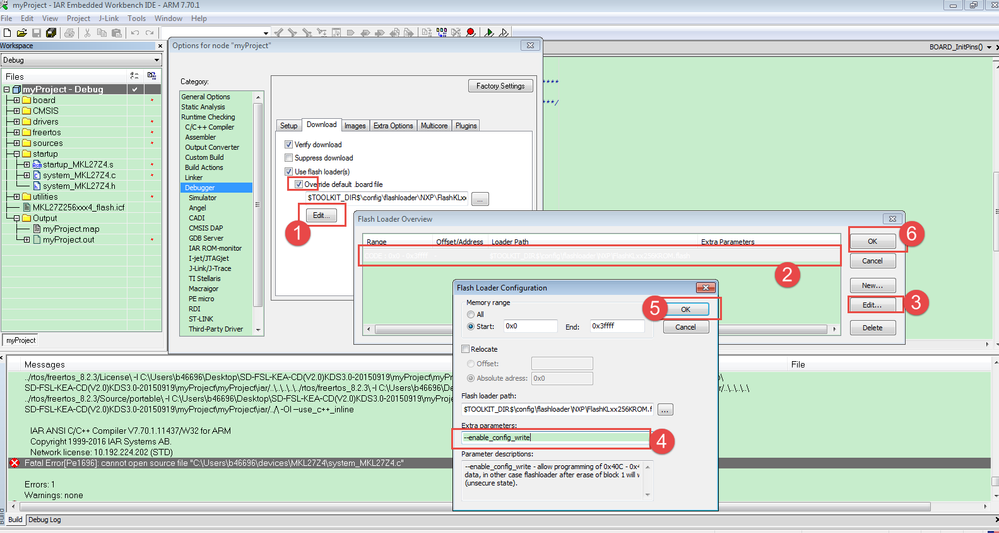

Verify error at address 0x0000040D, target byte: 0x3D, byte in file: 0x3F

Hi, I am working on the MKL27Z256VFM4 MCU and I am using IAR Embedded Workbench.
My project compiled successfully, but I received an error during the download to the target.
The warning is "Verify error at address 0x0000040D, target byte: 0x3D, byte in file: 0x3F"
Is any idea what is the problem about this? how to fix it? Will it cause any error in my program?

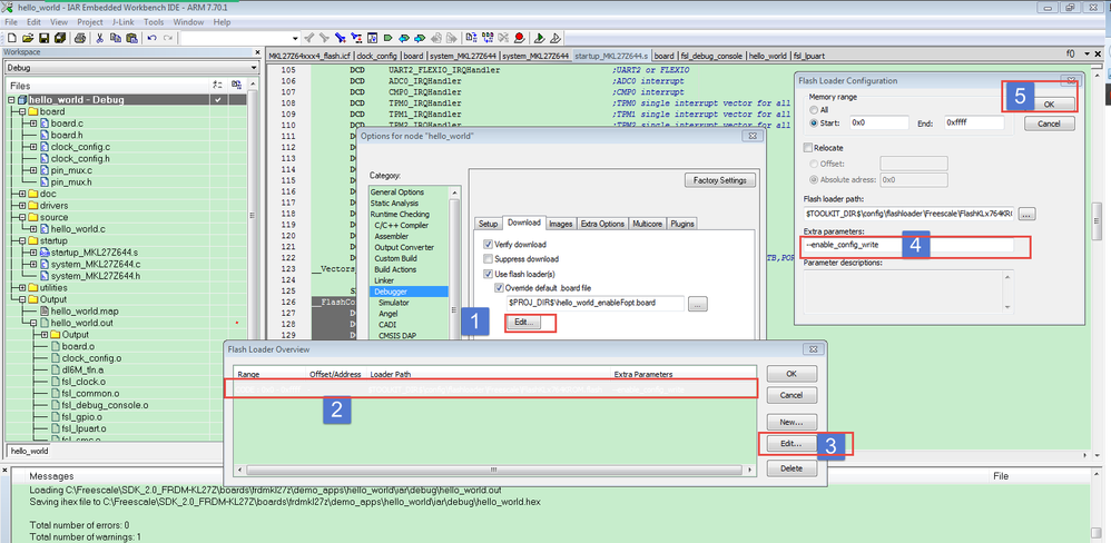

Hi Gilbert Liu,
    Your problem is caused by you modify the flash configuration field, this is protected by the IAR IDE.
0x0000040D is the FOTP area, if you want you want to modify it, you need edit your .board to add the extra parameters:--enable_config_write
  Just like this:
   Before you download the code, please do a mass erase at first, then download the code again.

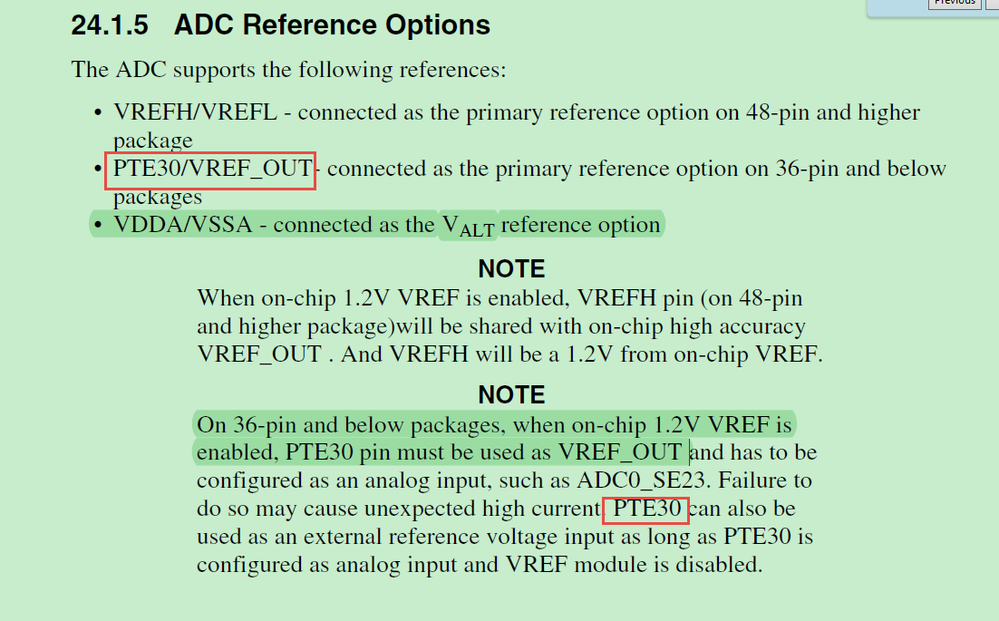

PTE0 ALT1 is the GPIO function, ALT4 is the RTC_CLKOUT function.
 PTE30 is a special pin, when the VREF is enabled, PTE30 is the VREF_OUT pin.

For the PTE30, I followed your recommendation, change the ADC0_SC2, REFSEL to 01, but still not working.

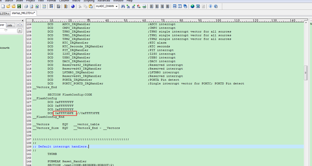

kerryzhou
Hi Gilbert,
     The project you give missed a lot of source file, so the project have a lot of build errors on my side.
  1.  Just as what I have told you, your problem is not enable the flash  configuration filed in the IAR, this problem is very very important!
2.       Your problem is report the 0X40D data, but what the function in the flash configuration filed 0x40d? Please read the reference manual:
So, this area also can disable the NMI function, please modify your 0X40D data to 0X3B.
Open "startup_MKL27Z4.s" file,  change line 130 to 0xFFFF3BFE
After the above 2 steps, then build again, download the code to your board, then PTA4 NMI function will be disabled, you can use it as the GPIO, it doen't matter.
Wish it helps you!

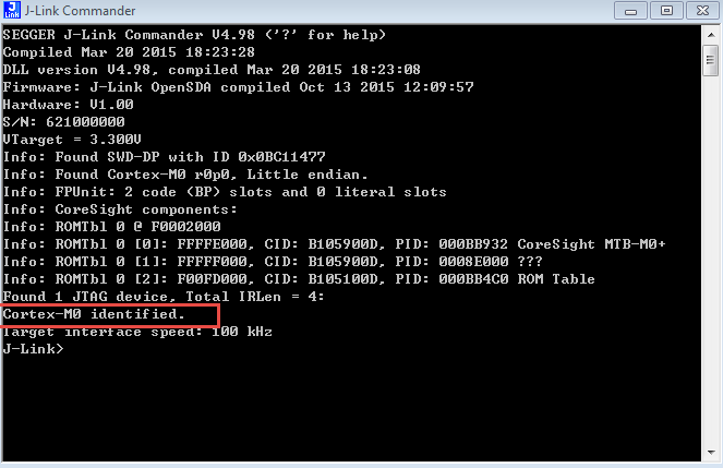

kerryzhou
Hi Gilbert,
   Did you design the board by yourself?
   When the picture you send me happens, you can use the JLINK command to check it, whether it can find the Core or not?

gsmgbl
Hi Kerry,
Yes, I am working my my own board.
Please advise the information how to use the JLink command to check. Thanks.
Yes, I have all the correct bypass cap and resistors on those pins.
Anyway, I copied the debug log and attached below for your information.

    Use the JLINK to connect your board, then open JLINK Commander window which you can find in your JLINK driver install path.
     This means you can find the core, if you can't find the core in your new board in the first time, you need to check your hardware.

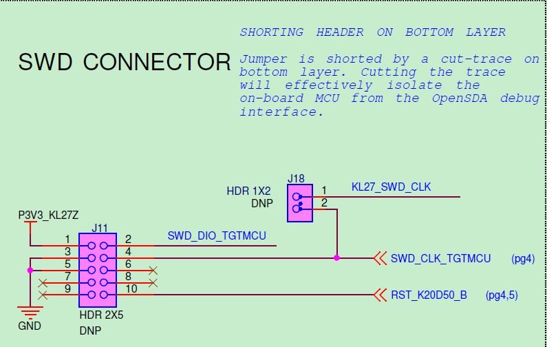

   About the reset, did you connect the reset pin to the SWD interface?
   Please refer to the FRDM-KL27 to design the SWD interface:
    SWD_DIO need add 10K pull up resistor.
  Reset need add 4.7k to 10K pullup resistor, and connect a 0.1uf capacitor to ground.
  NMI need add 4.7K to 10K pullup resistor.
  Please also check you hardware.
