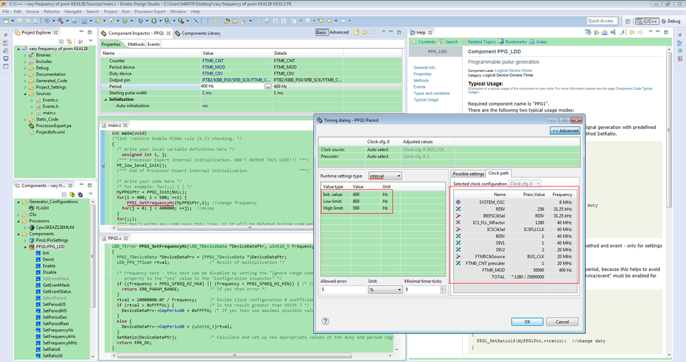

    I want to vary the frequency of pwm inKEA-128. I am using output compare mode and I want to vary PWM frequency between 300 Hz to 400 Hz, How do I do it, Can you give me any example for this?

The FTMx_MOD can be used to vary frequency of pwm.
If you are using Processor Expert with KDS3.2 , the PPG_LDD can be used to realize it.
Or you can refer the method of it.
