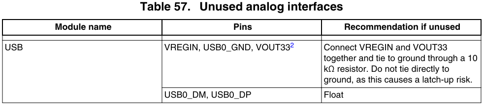

Hi All,
Can I make VREGIN pin of MK64FN1M0VLL12 as open?, i mean it is connected nowhere. I don't want to use USB
902 Views
gerardo_rodriguez
Hello ASHNO JAMES,
You can find NXP recommendation on handling the USB pins when this module isn't used in the Table 57. Unused analog interfaces in the K64F datasheet:
Gerardo
