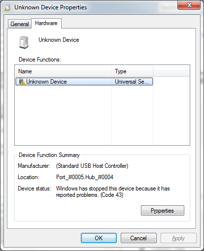

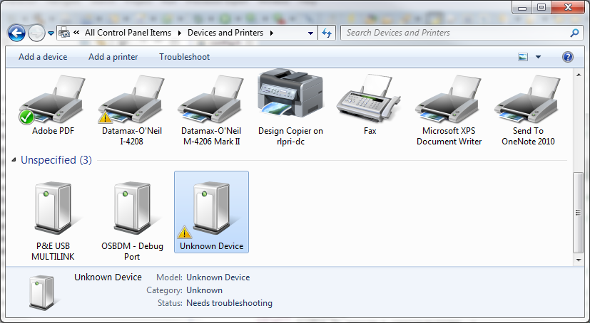

I am having issues getting the USB-MSD functionality of the Utasker bootloader going. I am using KDS with a PE debugger.
I have tried several different configurations and the K60 always shows up as "unknown device".
I have followed the gobs of documentation spaghetti, and twisted myself into knots trying to figure this out.

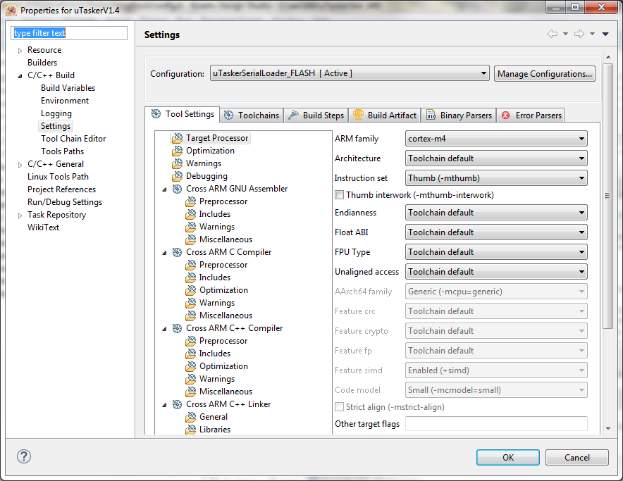

Guide for uTaskerV1.4.7 public version  for USB-MSD on TWR-K60F120M:
1. Import project into KDS 3.0 (or older KDS version)
2. Select "uTaskerSerialLoader"_FLASH target
Note: There is a funny with KDS (Eclipse) where the uTakerSerialBoot application directory may still be displayed grayed-out. This is cosmestic but can be solved by changing a KDS setting as discribed here:http://www.utasker.com/forum/index.php?topic=1883.0
It will however still build and operate correctly even if not done.
3. In the file Applications\uTaskerSerialBoot\config.h select the board TWR_K60F120M
4. In the same file enable USB device operation with #define USB_INTERFACE and disable HID_LOADER if you don't want USB KBOOT and then it will default to USB-MSD
5. In the KDS project properites ensure the compiler is setup to match the K60F120. See the KDS guide at http://www.utasker.com/kinetis/compilers.html#KDS in case of difficuties.
Essentially ensure the core is Cortex-M4 (and not Cortex-M0+) and use the linker script file K_1M_128.ld.

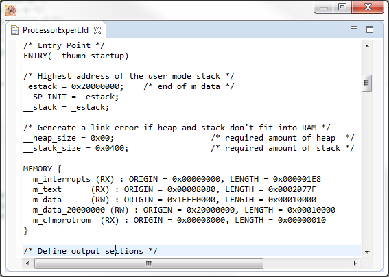

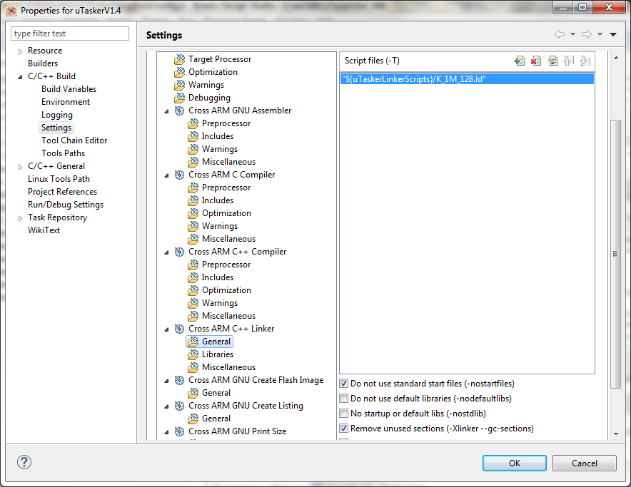

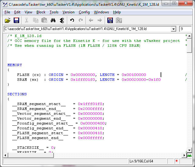

The problem I am having now may be a memory/startup location issue:
I can build a project and drop it's .bin file into the "UPLOAD_DISK", at which point the window goes away and appears that the bootloader goes away(heartbeat led stops). I then push reset to run my project, and the code does not run -The bootloader isn't restarting, indicating it is trying to run my code.
If I play with memory locations in the linker file of the application I built, this will change things - but haven't figured out what the right values are.

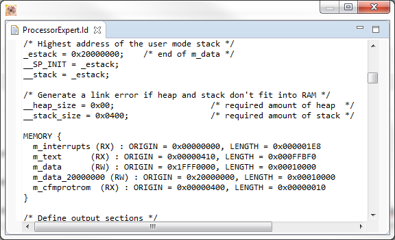

Here are the defualts for the Application Linker File:
And here is my latest try in modifying this

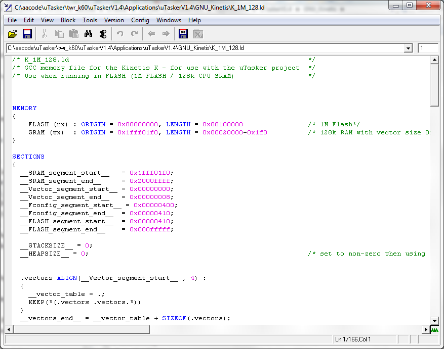

And here is the uTasker Linker File:
I flashed the application I built without the bootloader and it ran fine, so I am almost positive that the configuration of memory is off somewhere.
I appreciate any help I can get to move this along, thanks in advance!

mjbcswitzerland
Specialist V
William
You need to move yout reset/interrupt vectors from 0x00000000 since this space is occupied by the boot loader.
Effectively your m_interrupts must be at 0x8080 and not just your m_text (which can follow it). Note that 0x8080 is not a valid address to run interrupts from and the simpest method is to relocate interrupt vectors to RAM (this is also an option in PE).
The reference uTasker linker script to compare is K_1M_128_BM.ld (found in the uTaskerV1.4 project and not in the serial loader) since it is designed to link a project to operate together with the loader. The K_1M_128.ld is for the serial loader itself or a stand-alone application.

All right, I know the bootloader is configured right, I can load and run the "uTaskerV1.4.8_BM_TWR-K60F120M_8080.bin" example file just fine.
So it looks like my issue is with the application configuration. Could you post the configuration/memory/linker settings used from the "uTaskerV1.4.8_BM_TWR-K60F120M_8080.bin" example? I followed through with the configuration from your reply, but my code is not running when loaded like the example does.
Here is the linker file settings from the application I am trying to run:
I feel I am close because I am able to load the example, but something is off in my application that I need help with.
Thanks again!
