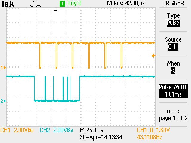

I was wondering how efficient is it to use GPIO as Slave Select pin ?. When I wrote a code in which I am using a default Chip select pin and side by side using GPIO pin just to test what the difference is on probing both the pins, I found the following waveforms. The yellow(channel 1) of the oscilloscope shows the inbuilt CS pin. the Blue(channel 2) of the oscilloscope shows the GPIO pin.
Here I am sending 6 bytes data so CS pin is going low 6 times in the first case it is going down in fixed interval but in later case CS pin is going to logic 0  for 6 times but not at fixed intervals. Below is the simple code which is in my infinite loop

I think what is happening here is that there is no wait after the send function before toggling the GPIO.
If you add a delay, or check for TCF flag on K-Series, after this function and before the GPIO toggle it should help you. What can happen after you call the send function is that the core will exit the function and move on to the next one before the SPI module has shifted the whole byte out.Therefore, the GPIO will not be toggling at the same rate that the bytes are leaving the SPI module.

Please be attention that GPIO is slow module, which exists delay when register was set or cleared. If customer want to use GPIO pin as SPI chip select, the GPIO pin toggle frequency should be slower than 2 MHz.
The key point your mentioned problem is not GPIO toggle frequency, please check if SPI communication interval time and SPI baud rate. Please add time delay between each  SPI communication and check again:
