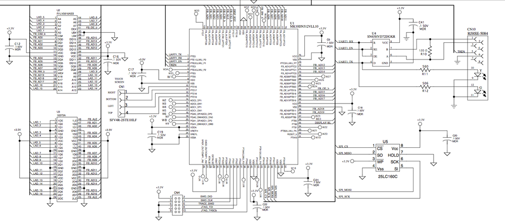

Hello everyone.  The 100 pin package does not have all 32 pins of the buss on the Flexbus.  I have a project with 8megs of external ram connected to the flex bus.  The RAM chip has a 16 bit bus and I have a 16 bit latch on the lower 16 bits of the Flexbus.
As far as I can tell, the signals look OK for a write, but when I try to read, I get the latch signal, R/W signal, and CE signal, but not the OE signal.  It always stays high.  As far as I can tell, it was enabled by processor expert when I look at the PE code.
I also tried changing the OE pin to a generic IO pin and I am able to toggle the pin in software, so the pin is not shorted.
Anybody have any suggestions?

Here's a partial schematic.  The chip is a MK10DN512VLL10.  There is an error in the schematic.  Pin 82 of the CPU should be connected to FB_AD5.

The schematics looks fine, was PTB19 initiliazed to another mux function in your code? You may add some code snippet  for read operation immediately after the code of flexbus initialization, and check if FB_OE works well as expected.

I don't know what caused the problem, but creating a new project seemed to work.
