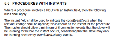

anca_codreanu
Hi @FedericoWegher ,
According to Core Spec, in a procedure which involves a PDU with an Instant field the master should allow a minimum of 6 connection events that the slave will be listening for before the instant occurs.
LL_CONNECTION_UPDATE_IND does have an Instant field so a delay of minimum 6 connection intervals should be expected.
In our implementation, a delay of 15 connection interval was chosen. You will receive an improved version of controller library which will use the minimum delay possible in accordance with specification(6) in top of MR2 release.
If you need more details please let us know.
