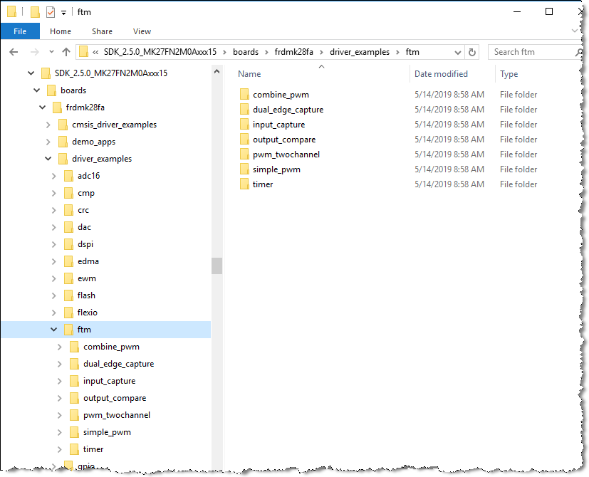

Have you refer the methods in ftm example of MCUXpresso SDK_2.5.0_MK27FN2M0Axxx15?
Try to find examples that are similar to what you need then test.

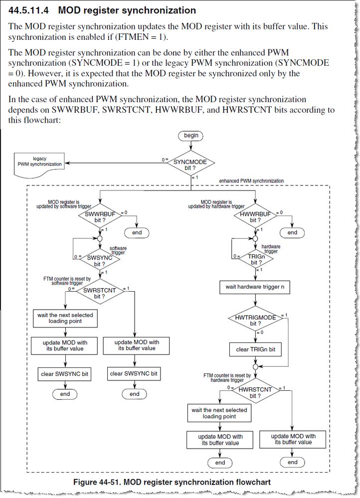

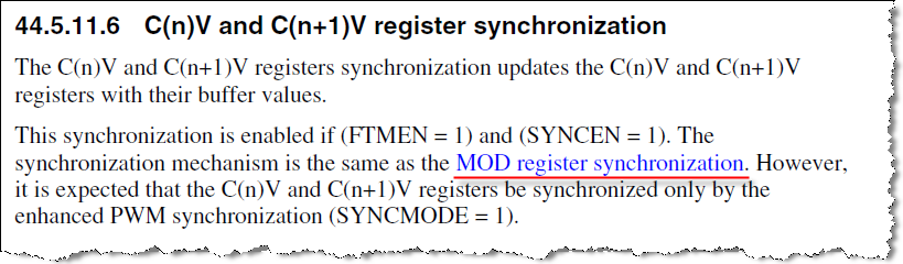

For more detail, please read the "44.5.11.4 MOD register synchronization".
