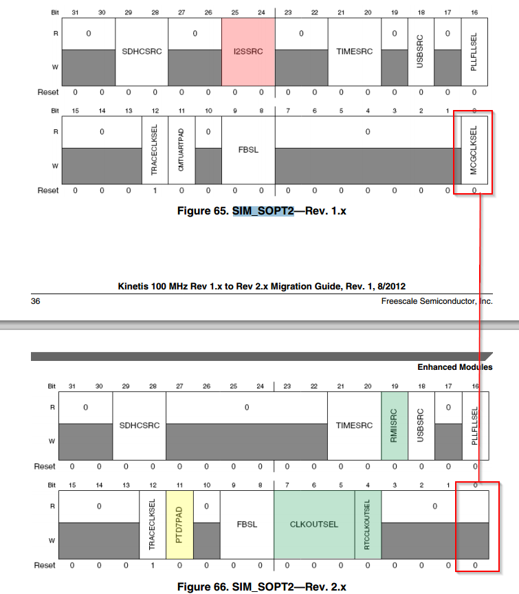

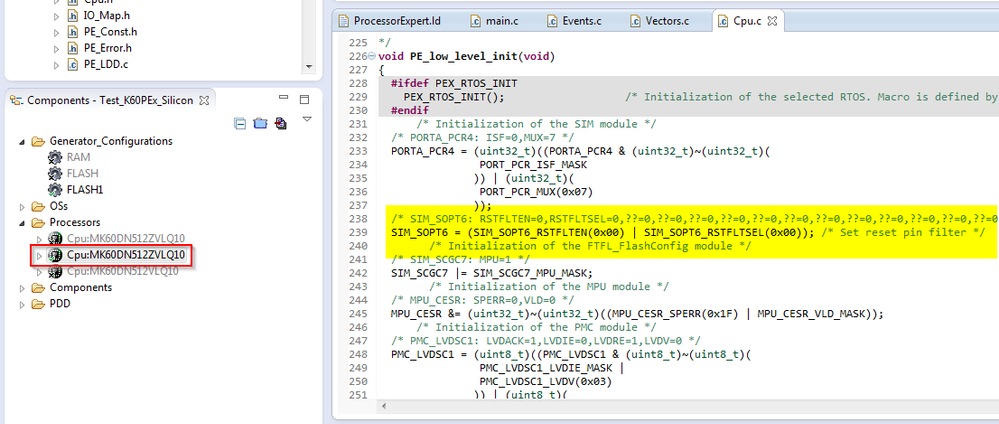

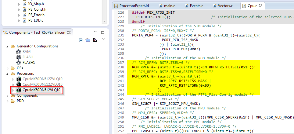

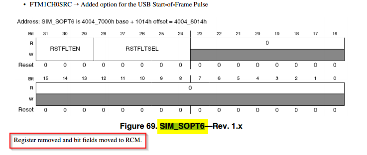

santiago_gonzal
Just before the access to SIM_SCGC7, you are accessing SIM_SOPT6, which does no longer exist on Rev 2.x silicon.
You can get more detailed information between silicon rev 1.x (xN30D) and silicon rev 2.x (xN22D) in the following Application note:
http://cache.freescale.com/files/32bit/doc/app_note/AN4445.pdf
This is the code that is causing the hard fault:
  SIM_SOPT6 = (SIM_SOPT6_RSTFLTEN(0x00) | SIM_SOPT6_RSTFLTSEL(0x00)); /* Set reset pin filter */
        /* Initialization of the FTFL_FlashConfig module */
  /* SIM_SCGC7: MPU=1 */
  SIM_SCGC7 |= SIM_SCGC7_MPU_MASK;

santiago_gonzal
You can add the two MCUs to Processor Expert's CPU section and it will take care of the changes between the two silicons, as you can see in the following images. But of you want to do a single binary file that can be used for both boards in production, then you will need to add if else conditions to write in one or the other register.

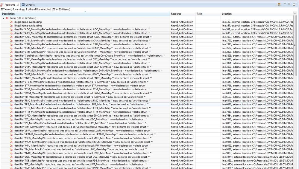

When i build the project and I include <MK60D10.h> I give some errors due to a re-declaration of some identifier (I attached an image of the errors).
Thanks for your help Santiago
/************************************ UPDATE ************************************/
Using the define to include <MK60D10.h> or <MK60DZ10.h> doesn't solve my problem.
The file IO_Map.h contain the list of define for the selected microcontroller, and this file is built by ProcessorExpert. I say this because I compare <IO_Map.h> and <MK60DZ10.h> and these two library are the same. Thus, if I include <MK60D10.h>, the compiler give me some errors because the microcontroller define are just defined in <IO_Map.h>.
My solution consist of add the content of <MK60D10.h> at the bottom of <IO_Map.h> and use two #ifdef two select the right portion of code.
Now the compiler give me new errors about undefined identifier ( MC_PMPROT, MCG_S_LOCK_MASK, PMC_REGSC_TRAMPO_MASK, SIM_SOPT2_MCGCLKSEL_MASK, WDOG_STCTRLH_STNDBYEN_MASK).
I think that this error is due to a registers modification applied in the silicon version 2 of MCU.

santiago_gonzal
If the compiler is reporting those as undefined identifiers, is because it is not able of find them. You need to make sure that they are defined in IO_Map or in the header you're finally using, and that you are including the header in the proper place.
I've checked and, for example, SIM_SOPT2_MCGCLKSEL_MASK, exists in Rev 1.x but not in 2.x. So if you try to use that code while you have SILICON_VERSION_2_X defined, you will get that compiler error.
2015-02-03 16_42_52-cache.freescale.com_files_32bit_doc_app_note_AN4445.pdf.png
Santiago

That error seems like an out of memory error, but I cannot assure it without debbuging the code. Can you tell me the two exact Part numbers of the Kinetis devices you are using? Do they have the same amount of RAM memory?
There is also a change in the USBSTBY bit in SIM_SOPT1 register that could generate some problems when using the same USB code in the two different platforms. I would have a look into that bit also.
Santiago

Hello Santiago,
thanks for your Reply!
My first firmware was developed for MK60DN256ZVLL10 but now I want to adapt the firmware to MK60DX256VLL10 (my sample has this code: PK60DX256VLL10.
Thanks for your time
