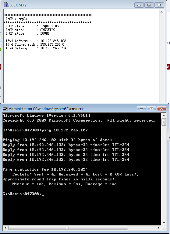

danielchen
Hi Kermith:
I tried the frdm64f_lwip_dhcp_freertos demo, it can work on my side. Then I ping the board from my PC, it seems stable. Please see below picture.
