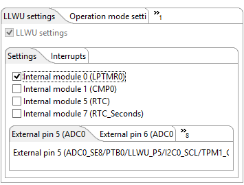

I am using an MKL24Z64VLH4 with KDS 3.1.0.
I have a simple routine which I am trying to debug:
1) Go to sleep.
2) Use LPTMR0 to wake me up.

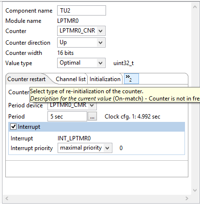

I have TU2 programmed as LPTMR0 with the interrupt enabled.
And it's set to Auto-init. I also have the LLWU interrupt enabled in the CPU configuration
I've also tried ensuring I use the BLPI Clock (I have two clock configs- one is for low power mode, the other for normal operation).
I also considered the possibility that I was waking up but just not seeing my message because of the change in clock configurations messing with the baud rate, but if I remove the DOM_STOP instruction the Serial port is fine.
Thoughts on what I may be doing wrong? I can supply a sample project if necessary.

mjbcswitzerland
Specialist V
Roger
The LPTMR only operates when clocked by a source that also runs in the low power mode - check that it is not configured to run from one that is stopped in the mode that you use.
Mark
