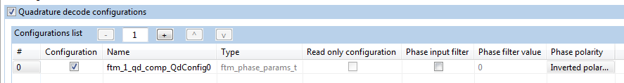

On other processors I have used, like the dsPIC, I can just invert the polarity of the input channels.  I've tried this in the following ways:
  1. set the FTM_QDCTRL_PHAPOL_MASK and FTM_QDCTRL_PHBPOL_MASK bits in FTMx_QDCTRL
  2. cleared the FTM_QDCTRL_PHAPOL_MASK and FTM_QDCTRL_PHBPOL_MASK bits in FTMx_QDCTRL
  3. set the Invert Polarity setting in Processor Expert
  4. all permutations of the above
In *all* cases, the sign of my encoder value is always the same.  I would have expected one of the combinations to result in a flipped sign.

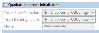

In the process of debugging this, I realized that I had never checked the "Quadrature decode initialization" checkbox in processor expert:
I interpreted this to mean that even though I have "Quadrature decode configurations" checked, the settings in the configuration list as shown below would *not* take effect:
So I also tried to check "Quadrature decode initialization", but when I did this, the encoder readings I got back had the wrong sign *and* magnitude.
At this point, I'm under the impression that 1) I am missing an undocumented step (perhaps another register needs to be cleared before I can invert polarity, 2) processor expert has a bug, or 3) I should just punt on this and swap the wiring.
