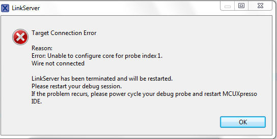

I am trying to debug MK22FX512AVLQ12 using MCUXpresso IDE and PEMicro Multilink Universal (Rev. D) but I am unable to debug. I also tried to debug the same using LPC11U68 board but still not able to debug. In both the cases I have used the SWD interface (SWD DIO and SWDCLK pins).
I have attached the screenshots of the error I get in both the cases.
Also I have observed that the RESET Pin of the controller is always in low state despite of an external pull up resistor on the pin.
Please help in resolving the issue.

There is an update. Now I am able to get the sawtooth waveform on RESET pin (which is expected behaviour for blank chip) but still unable to debug the controller.
The hardware specifications are as mentioned above. I have attached schematics for the SWD interface connection. We have also connected EZP_CS_b pin (pin 54) to VDD explicitely.
For software part, I am using MCUXpresso IDE and SDK_2.3.1_MK22FX512Axxx12.
Pleaes help in resolving the issue.

First of all, SWDIO need a pullup resistor.
The sawtooth waveform may caused by many reason. Please see the attachment.

vaibhavi_padwal
After following modification in hardware, as suggested in https://community.nxp.com/thread/518934 I am able to program the controller using JLINK as well as PE Micro.
1. 4.7K pull up on NMI Pin
2. 10K pull up on SWD-DIO
3. 100 Ohm and 2.2uF RC on VOUT33 pin
4. 1nF capacitor on SWD-CLK
I am able to program using MCUXpresso multiple times without any errors. The issue is resolved now.
Thank you for you suggestions and quick replies.
Vaibhavi
