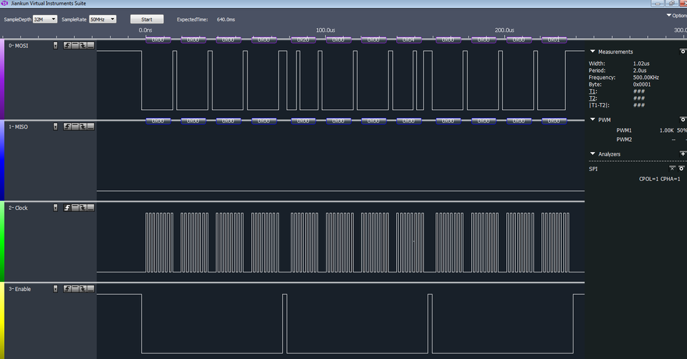

kanimozhiraju
hi ,
      I checked it out and data is trasnmitting when chip select gets low.but not proper datas are transmitting.Its transmitting someothr data other than what i have given.but transmission is happening.

kerryzhou
Hello Kanimozhi Raju,
   Please attach your SPI wave when you do the communication.
  It is useful to my analysis.

kanimozhiraju
hi kerryzhou
                 I have attached the spi waveform.First i use 4mhz datas are not visible for me.then i have changed clock and enable cont sck and then i have used.D0-SCK,D1-MOSI,D2-MISO,D3-CS...I have sent you the waveform of mosi sck and cs.The data what i have try to write is not written.It would be great if its resolved.Thank you.

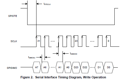

egoodii
Senior Contributor III
Unless your SPI device is 'very unusual' (and it is NOT) remove SCKE from line 74.  Optimizing the timing so CS just hits 'exactly 32 clocks' from within a continuous stream is 'more trouble than you need'.
You have no PCS value in lines 292 and 353.  The Chip-select pattern MUST remain thru the whole four bytes (A/D3/D2/D1).  I would expect you only need PCS0 (per line 60), so '1' for all PCS fields (lines 260/271/281/292/313/326/339/353).  This code also still has '|=' for all SR writes, please replace with just '=' !!!
AFE4490:
