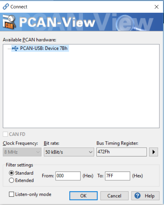

I am unable to send/receive CAN msgs to PCAN adapter from K66F microcontroller, my connection setup is as follows,
K66F is connected to CAN-Transceiver TJA1050 (120 ohms terminated) to CANH and CANL of Peak can adapter(120 ohms terminated). I am using SDK Flexcan loopback example and modified can bus timing and also made sure that baud rate is 50 kbps when I connect CANH and CANL to oscilloscope all I see is error frames, bit stuff error frames and unknown CAN message with unknown ID.  I think the problem is with setting bus timing. Please find the modified K66F flex can loopback code.

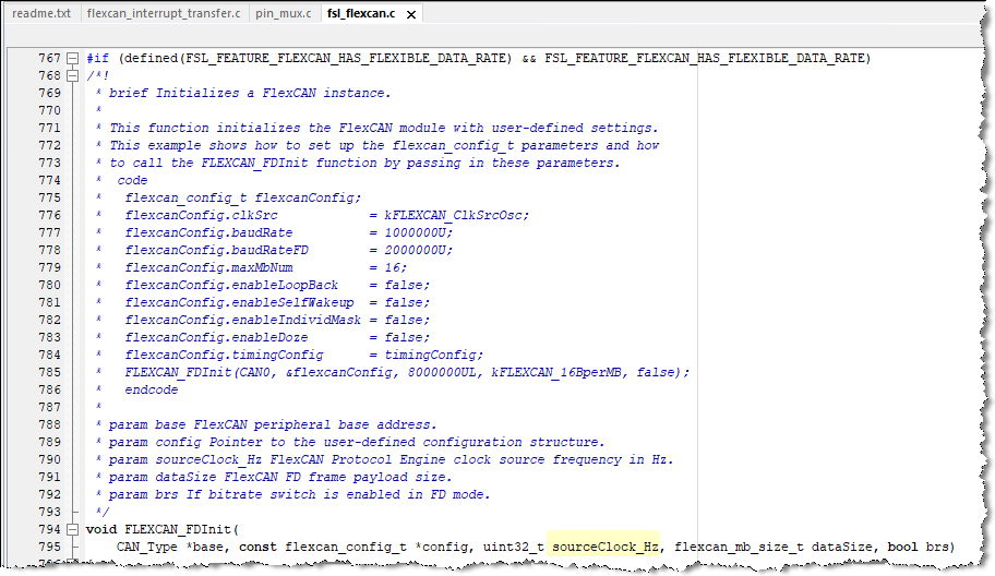

Hi Steffen Probst,

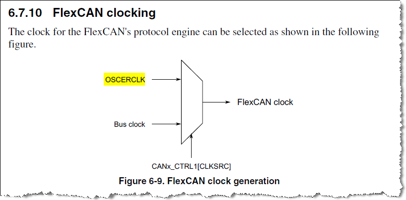

Seems that you have refer the flexcan_interrupt_transfer of TWR-K65F180M SDK.
According to your codes, OSCERCLK is select as the clock for the FlexCAN instead of Bus clock
So the sourceClock_Hz of FLEXCAN_FDInit should not be 12000000UL?
The oscilloscope should be able to observe the bit time, would you please measure if the bit time meet the baud rate?

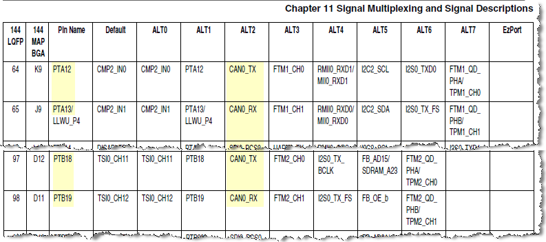

Additionally, CAN0_TX and CAN0_RX need to configure.
For example:
    /* Port B Clock Gate Control: Clock enabled */
    CLOCK_EnableClock(kCLOCK_PortB);
    /* PORTB18 (pin D12) is configured as CAN0_TX */
    PORT_SetPinMux(PORTB, 18U, kPORT_MuxAlt2);
    /* PORTB19 (pin D11) is configured as CAN0_RX */
    PORT_SetPinMux(PORTB, 19U, kPORT_MuxAlt2);
