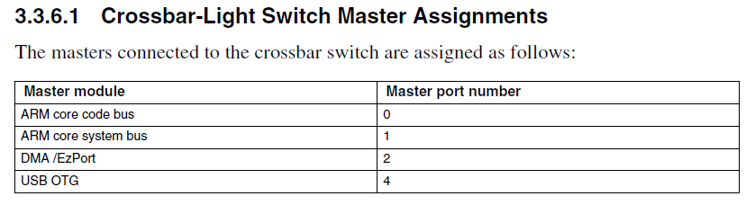

If the descriptor size is correct but its content is bad you probably need to configure FMC_PFAPR to give the USB controller access rights to flash memory (where the decriptors are probably resident). Probably the old USB stack that you are using is not device aware and so doesn't configure all things that are needed.

I looked at the FMC_PFAPR register, but this only says master1-7 etc, is there any overview where the different masters are selected ?
