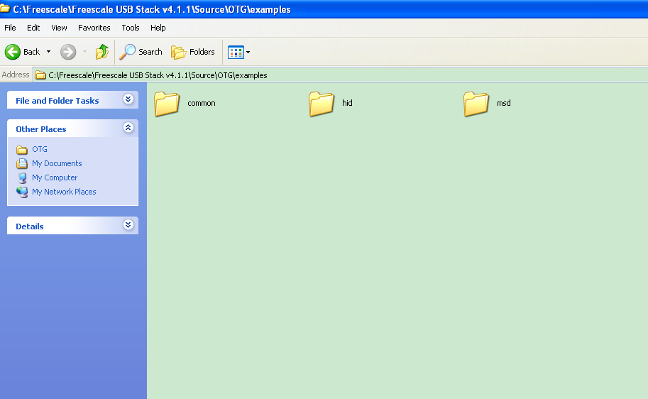

Kan_Li
Actually Freescale USB Stack 4.1.1 supports OTG now, and you may download it from USB Stack, after installation, you may find the demos as shown the following snapshot;
Hope that helps,
