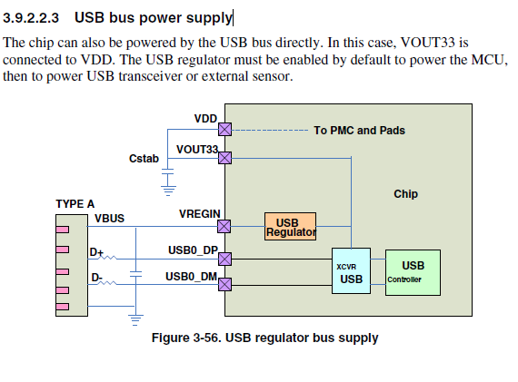

Thansk for the answers! I checked vregin and vout33 and noticed, that those are not connected. That means, we don't have power on the usb controller.
The problem is, that we have to change the layout completely, which will take us 3-4 weeks.
I checked the K60 reference manual and noticed, that there is a USB bus power supply where VOUT33 is connected to VDD. Can I do this with the software? Maybe with setting a register? Or do we have to change the layout and fix the hardware?
Thank you for your help!

For hardware's point of view, It is important to add a Capacitor on VOUT33 terminal.

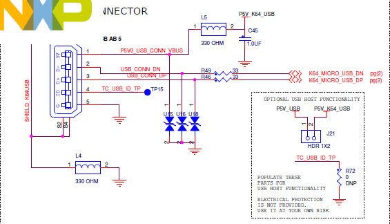

Also, make sure that USB hardware is similir to the one used in FRDM-K64F:

It is not good to work with fixed pull-ups so these should certainly be removed.
The way that the D+ line is pulled up when the USB interface is configured is using (similar code to) the following:
USB_USBTRC0 = USB_USBTRC0_RES; // this bit is not defined but should be set for correct operation
USB_OTG_CONTROL = USB_OTG_CONTROL_DPPULLUPNONOTG; // enable pull up on D+ for full speed operation
Check also your VREG_IN/VREG_OUT circuitry too since I have worked on various Kinetis based USB device projects on custom boards and almost half of them needed to correct this because the prototype design was not correct....
