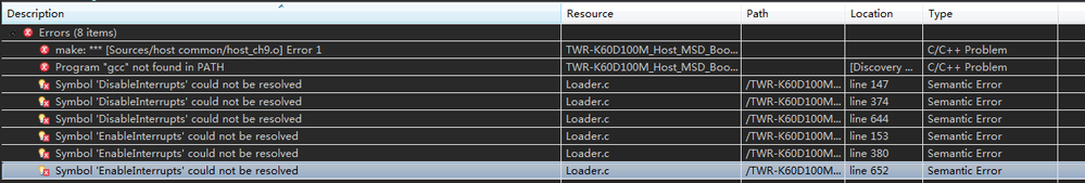

Thank you for your warmhearted! I download your project, but it error.
3,073件の閲覧回数
isaacavila
Hello Keetle
Which CW version are you using? I have tested it on CW 10.6 and CW 10.3 and it was compiled correctly!
Isaac
3,073件の閲覧回数
keetle
I am using KDS3.0, not a CW version, so it is the problem.
Thank you for your help.:smileyhappy:
