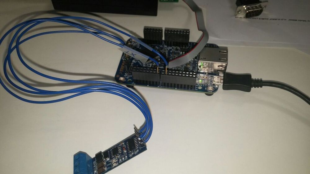

I've connected the FRDM as follows:
The small board below is an RS485 to UART. The UART RX is connected to J2/4 (TX), the UART TX is connected to J1/16 (RX).
GND & Vcc is connected to J199 GND & Vcc (I've left it there because I've used to work through UART4 - works great with that setup, now I want to move to UART1).
Any idea you can think off?

Ok,here's an update:
Using your bin, when I reset the board, I get on my Real term:
'rs 485 example'
But they are shown when I'm connected to the UART of the OpenSDA (UART0). I've double checked it. In UART1 (where my RS485 to UART is connected) I don't get anything.
I even disconnected my USB dongle (which converts USB to RS485, and then it goes to the small board) and still, when reset is clicked I get this string in Real term.
Thanks anyway for your help.

"rs 485 example" doesn't exist in the binary so it must be coming from somewhere else (are you sure your RS485 cable works and could it be that you haven't loaded the binary correctly, or loaded the wrong one?).

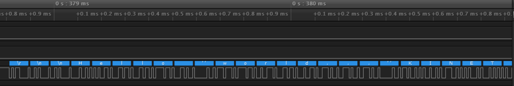

This is the logic analyser output of PTC4 on J2/4 (Tx UART1 of K64) when I load the binary to the FRDM-K64F:
As you can see, it sends "Hello World - Kinetis....." at 115200 Baud.
Note that the green LED flashes at 2.5Hz when it is operating normally.
The output is just UART so can be talked to with Real term, TeraTerm, or whatever terminal emulator you want.
This means that
- you may not have correctly loaded the binary file (I do it with drag-and-drop using the OpenSDA loader).
- or your RS485 convert is not working, or is connected incorrectly
- or you have some other HW problem
