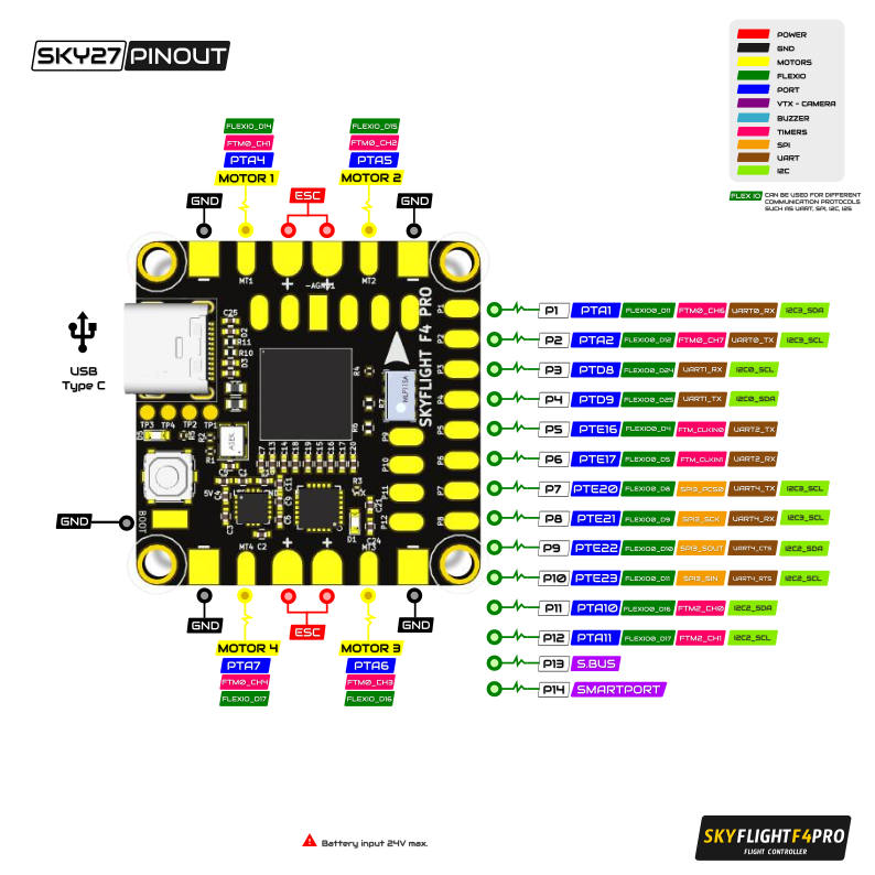

K27/28 has DTE/DCE interfaces like as iMX family?
or is there any other way to invert a UART connection without the need to add an external circuit?
Is not this a problem with FLEXIO?
I need to invert the UART connection to Futaba S.BUS and FrSky Smartport.

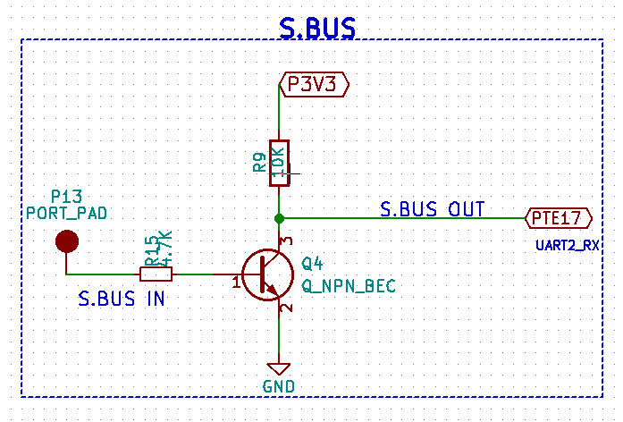

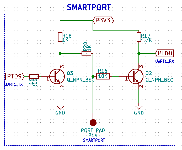

javierhernande1
Hi Mark,
Thank you for the reply,
I have not understood it very well, so I am going to implement the external circuits for S.Bus and Smartport, just in case I can not do it via software.
With FlexIO is not easier.
By the way, uTasker supports FlexIO?
Normally when an inverter is not added, the inverted signal is used from the receiver. But you have to be modifying the receiver. As explained here.
Javier
EDITED: I have done these circuits to S.Bus and Smartport
