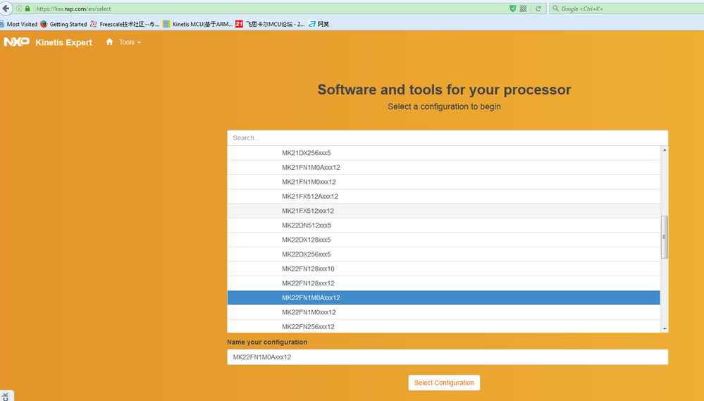

You can refer to KSDK2.0 code which can be download from this link:
Welcome to Kinetis Expert | Kinetis Expert
Click build an sdk button,  then select the processor like this:
Generate the code ,and download it, you will find the uart code in folder: SDK_2.0_MK22FN1M0Axxx12\boards\twrk21f120m\driver_examples\uart
Wish it helps you!
