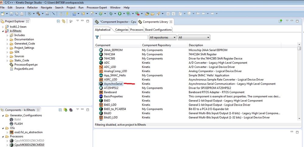

I want to use RS232 to send/receive data from my MK50DX256 board. I have a working program in Codewarrior using "Aychroserial bean". I want to write the same in KDS. Which bean should I use? I tried using fsl_uart but in vain.

danielchen
I can find the "aychroserial" in KDS 3.2, is it right for your requirement ? please check the below picture

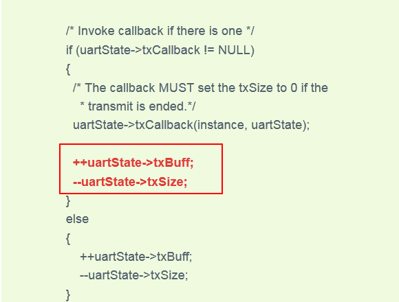

danielchen
Hi Kirantujare:
The component "asynchroserial" is not supported for your processor, I think you need to use "fsl_uart". But there is a bug on the function of "UART_DRV_IRQHandler", in file fsl_uart_driver.c. you need to add the following two red lines to  the receive interrupt and send interrupt. Please check the below picture.
