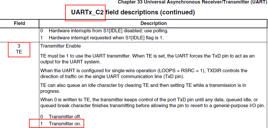

Hello Ajith,
Have you enable the Transmitter  ? here :
If also done , please show your code , or it hard to find your problem , thank !
