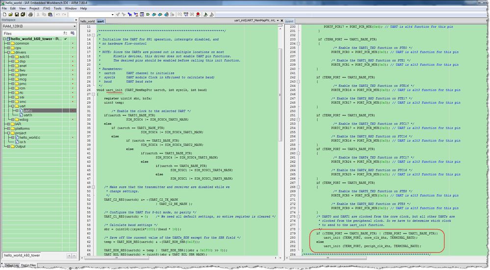

      I'm learning UART of PK60FN1M0VLQ12 resently,but I have been using the demo of MK60DN512ZVLQ10,
now there are some incompatibale between the two chips .The main problem is that clock initialization can't be down ,cause some registers differ.
      So if you guys can email me some demo of PK60FN1M0VLQ12 to initialize clock ,so I can configure baud rate.
Thanks for your help .
1 返信
861件の閲覧回数
Robin_Shen
Hi 冬 李,

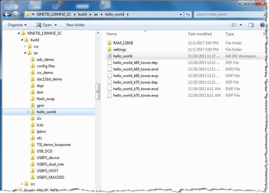

You can download the KINETIS_120MHZ_SC and then refer the uart_init function in hello world example.

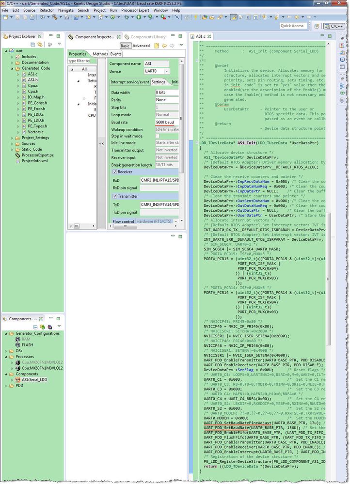

If you are using CodeWarrior10.x or KDS ide, then you can refer the UART configuration auto generated by Processor Expert.
