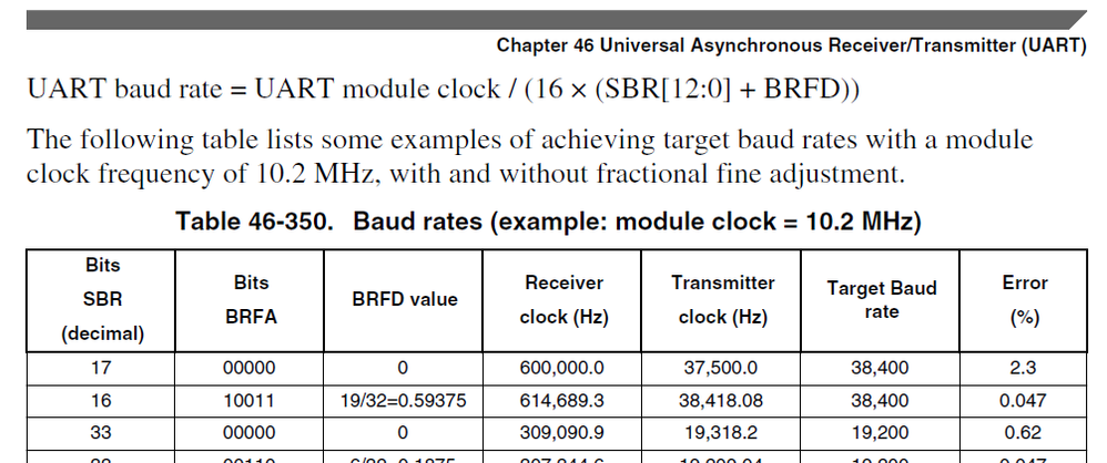

I have to set the registers of the UART (BDH, BDL) of a MK10 to receive a UP501 GPS module.
The GPS baud rate is 9600 (I think the UART baud rate in the formula below).
the UART module clock is 96 MHz (UART module clock in the formula below).
Using the datasheet formula is shown below:
I have a much larger value of the size of the registers that I have at our disposal.
How does it work?
In a program I've found is handled as follows.
// compute baud-rate generation values
uint32_t tmp = 2 * *uart_clocks[dev] / baud_rate;  // this equals 32 * (SBR + BRFD)
uart->BDH = tmp >> 13;
uart->BDL = (tmp >> 5) & 0xFF;
I think, that the shift operation is performed because the data is too big but as I understand how shiftare? And then the value does not change?

You could find UART baud rate calculate forum is :
The code:
The tmp now is 32 * (SBR + BRFD)
The code :
is actually do two steps calculate:
1> tmp >> 5 (tmp divide by 32), will get (SBR + BRFD) value;
2> (tmp >> 5) >>8 to get SBR[13:9] bit value to UART0_BDH register;
The code :
uart->BDL = (tmp >> 5) & 0xFF;      //make the same calculate.
Wish it helps.
Ma Hui

The UART baud rate register SBR has 12bit setting for integer.
Wish it helps.
Ma Hui
