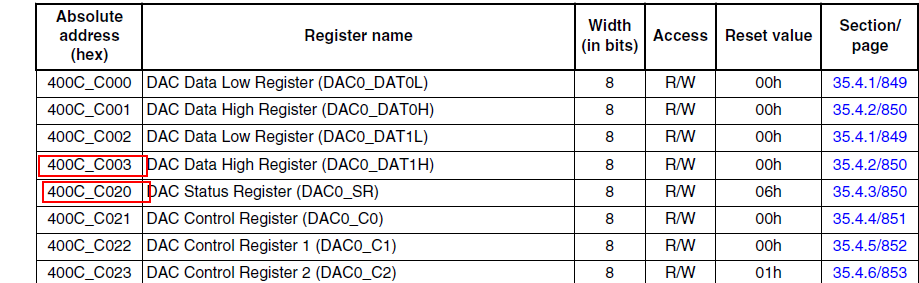

K22P144M120SF5V2RM.pdf, dated Mar 2015, Revision 5, says that the 12-bit DAC has only 2 12-bit data registers, DAT0L/H and DAT1L/H.  The RM also has references to 16 data registers that were probably left over when the RM was edited.  However, when trying to port my DAC code from the TWR K40, which worked with the 16 data registers, it also works in the MK22FX512A.  And the debugger sees all 16 data registers, DAT0L/H thru DAT15L/H.  Is the RM wrong?  Or should I not be using all 16 data registers?

I've confirmed that the MK22FX512AVLQ12 contains the 16 data registers and I'll report this doc error to the Document team for checking.

I think this is a bug or some simple write on the K22P144M120SF5V2RM.pdf, dated Mar 2015, Revision 5,.
For we can see that , when we create on project about this chip , there will 16 DATA registers , and aslo
in the old version , for example :
Document Number: K22P144M120SF5RM
Rev. 3, April 2014
it list all of them :
And in the new version , we can see the memory of DATA2-DATA15 have not been occupied by other register .
So i this the DAC of this K22 chip have 16 DAC_DAT registers.

Note that the two RMs you mention are for different chips.  I am using the MK22FX512AVLQ12 for which the ...V2RM.pdf is supposed to cover.  The other RM does not cover the 'A' version of the uP.

The K40 contains the 12-bit DAC module which is as same as the K22's. The DATnL/H provides 16 bit to set the DAC output, however the 7~4 bits of the DAC_DACnH are reserved.
