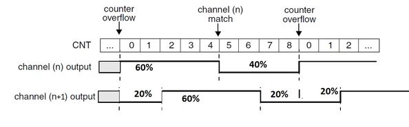

Hi, i have a kea 128 and i want to generate 2 out of phase PWM signals. I have selected FTM2 ch0 and ch1 for my purpose. PWM signals duty cycle must be 60%. Could you help me please?

I solved the problem by setting a channel with ELSnA = 1. So the output channel become 1 at the match up, to the counter overflow

EmanueleP
 Thanks for your help, but i'm trying to configure the two PWM signals as shown in the picture.
I don't know if this type of configuration is supported by a single FTM module or if i'm forced to use 2 FTM modules: one channel of FTM0 in edge-aligned mode and one channel of FTM1  in center-aligned mode.

_Leo_
It is possible to configure the channels of the same FTM module differently. So yes, you only need one module.
However, for what you are looking for, it may be more convenient to make a Phase-shift PWM signal, for more details about this please refer to section 3.4 of application note AN5142.

EmanueleP
So, in this way i have to use 4 channels? In this way i lose 2 channel.

EmanueleP
I would like to use two FTM channels to have 2 output singals with different phase. To use the application note method I need 4 FTM channels if I'm not mistaken. Now i'm try tu use ELSnA on one channel to set Low-true pulses (set Output on match-up) (26.3.6 chapter of kea128rm manual).

EmanueleP
