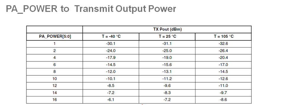

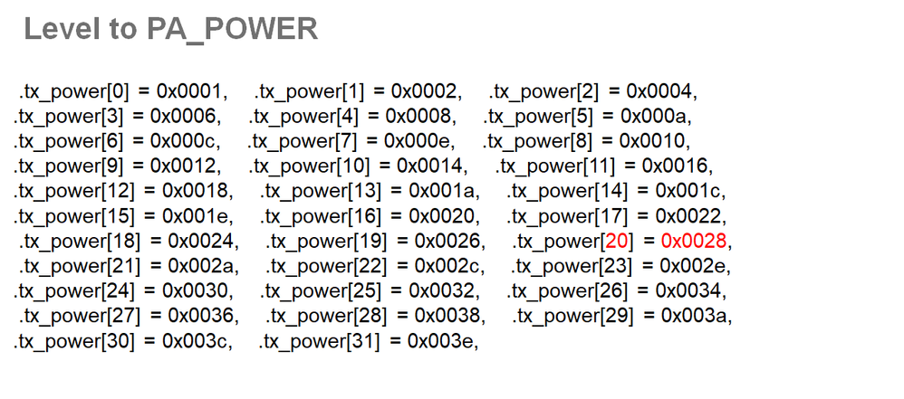

Add the following 2 MACROs in the file preinclude.h. The relationship between the set value and the transmit power can be calculated by the following table.
#define mAdvertisingDefaultTxPower_c 20
#define mConnectionDefaultTxPower_c 20
      0x0028 = 40, so if the setting value is 20, the Tx power is 0.3dBm at 25 ℃.

nsuresh2
Hi XingChang‌,
Thanks for your quick response.
So as mentioned above both the macros are enabled and set to the default value of 20
When we measure the power it shows -2.39 dBm at room temperature, but as per the above table it should be 0.3 dBm
What could be the reason for this? Any other parameters that need to be looked into this for power deviation?

xing_chang
Hi nsuresh2@visteon.com‌,
The transmit power we measured at the PIN of the chip, if you measure from the SMA, your measurement is reduced by the RF line loss. This is usually around 1dBm, but your loss is a bit big. Please check if the matching network is suitable.
