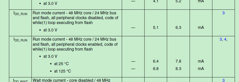

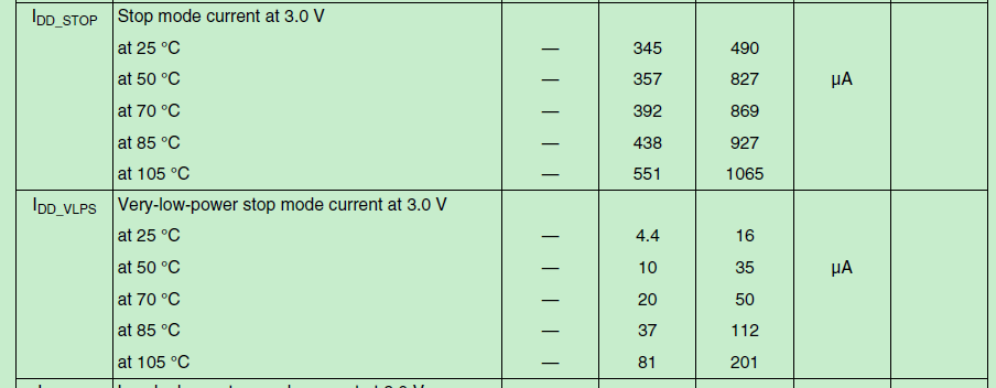

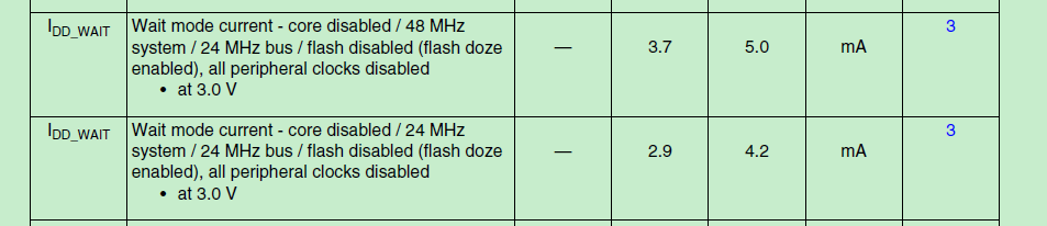

I measured supply current with the "power manager demo" on frdm-kl25z board (KL25Z128VLK). The current in Stop mode is much larger than I would expect. What could be causing this. Current measured from J4 on frdm-kl25z using multimeter.
mode:  current [mA]
run      9.3
wait      5.4
stop      4.7
vlps      4.7
620 Views

Hi Tuomas aaltio,
   When you test the low power, please download the code to your FRDM-KL25, then exit the debug mode, just check the current directly.
   I have test it on my side, it meet the demand.
RUN:6mA
WAIT:4.92mA
STOP:0.31mA
VLPS:10.2uA
All these data meet the datasheet demand:
My board version is:
700-27556 REVA
SCH-27666 REVE.
Wish it helps you!
Kerry

tuomasaaltio
I tested it with emulator disconnected, the result in RUN and VLPR mode are still too high.
RUN 8.9mA
VLPR 1.4mA
WAIT 5.0mA
STOP 0.4mA
700-27556 REV A1
SCH-27666 REV F.
620 Views

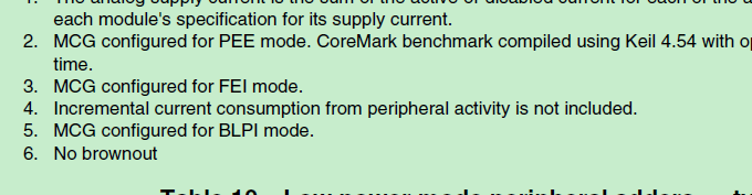

kerryzhou
Hi tuomas aaltio,
  Please use this code for FRDM-KL25:
http://www.nxp.com/assets/downloads/data/en/lab-test-software/KL25_SC.exe
After you download and install it, you can find the low power code in folder:kl25_sc_rev10\klxx-sc-baremetal\build\iar\low_power_demo
This code, run is 6.24mA, VLPR please use I, it is 0.22mA, in BLPI, this is the clock mode which is defined in the datasheet:
I have test the power consumption with the kl25_SC.exe in the same board reversion as you.
Please try this code again.
Wish it helps you!
Kerry
