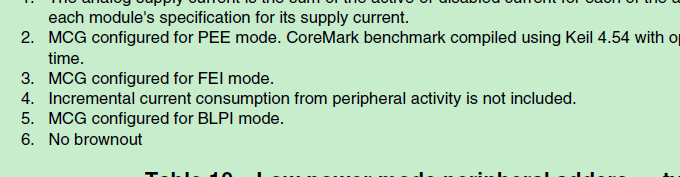

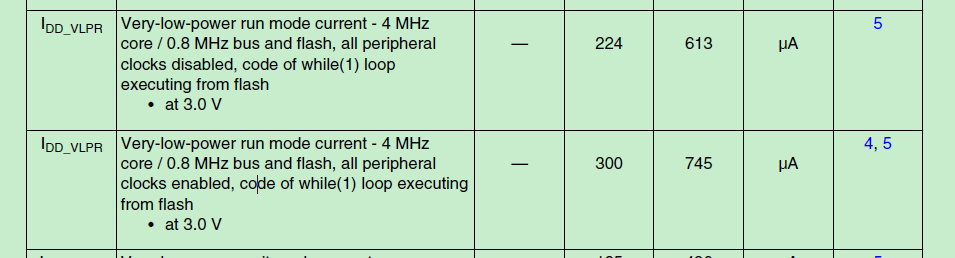

This code, run is 6.24mA, VLPR please use I, it is 0.22mA, in BLPI, this is the clock mode which is defined in the datasheet:
I have test the power consumption with the kl25_SC.exe in the same board reversion as you.
Please try this code again.
