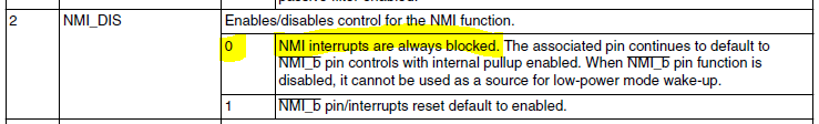

The PTB5 is configured as the normal input pin (ALT1) in my project.
My project works normally when the PTB5 input pin’s value=1.
But the project cannot work normally when the PTB5 input pin’s value=0.
All the interrupts in my project cannot work only more--the timer interrupt, the SPI interrupt and so on.
I think it is caused by the “NMI_b” property in the PTB5.
Can you tell me how to solve the problem?

Disable the NMI function at the pin in the FTFA_FOPT setting:
To do this you need to edit the Flash Configuration settings.
In the uTasker project it is done by configuring the define
#define KINETIS_FLASH_CONFIGURATION_NONVOL_OPTION  (FTFL_FOPT_RESET_PIN_ENABLED | FTFL_FOPT_LPBOOT_NORMAL | FTFL_FOPT_NMI_DISABLED)
In other libraries you may have to search for an assembler file containing these values and modify them manually.

The IAR is used in the project.
But FTFA_FOPT cannot be changed in the debug mode.
After the firmware is downloaded from the IAR, the value from 0x400 to 0x40B has been changed.
But the value in the 0x40D(FTFA_FOPT) cannot be changed.
So my project still cannot work normally when the firmware is downloaded by the IAR.
And I generate the .bin file by the IAR and find that the value in the 0x40D(FTFA_FOPT) can be changed.
Can you tell me why the value in the 0x40D(FTFA_FOPT) cannot be changed in the debug mode?

Hi Robin,
   IAR is special, you need to enter :
--enable_config_write “ in Flash loader configuration windows.
More details, please check my attached doc, it is for KL03 in IAR to modify the FOPT register, but KL02 is the same.
Wish it helps you!
Kerry
3,962 Views
小勇邹
Hi Kerry,
Thank you very much. My project can work normally now after entering ” --enable_config_write “ in Flash loader configuration windows.

Why all the other interrupts are failed when the NMI_b of the PTB5 is enabled
When should we use the function of the NMI_b of the PTB5?
3,962 Views
kerryzhou
Hi Robin,
 Sorry for my later reply because of China's National Day and Mid-Autumn Festival.
I don't think if the NMI is enabled, other interrupts are failed if your NMI interrupt is not triggered.
You can make sure PTB5 is higher, then check other interrupt, it should works. But if your NMI is low, your code will enter NMI interrupt and always in that handler, it will caused other interrupt can't enter.
