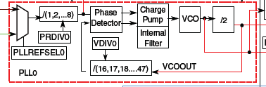

I'm creating the project with MK60FN1M0VLQ15. I use external clock 25MHz.
When I move from PEI mode to PEE mode 150 MHz, I have got MCGCLKOUT 75 MHz (on TRACE_CLKOUT 18,8 MHz, on FB_CLK 25MHz).
But I've expected 150 MHz.
MCGCLKOUT=25 MHz*18/3
VDIV0=0x02 (18), PRDIV=0x02 (3).
But I have got 150 MHz only when VDIV0=0x14 (36).
What is it? An error in datasheat or my error?
Please, help me to find a mistake!

Hi Nataliya,
On the Kinetis devices with a DDR controller, there is a fixed divide by 2 from the PLL VCO frequency that I think you aren't taking into account. Here's the PLL section of the MCG block diagram:
Notice the /2 block on the right side.
So to clock the core at 150MHz you do actually want a VDIV of 36 :
25MHz * (36/3) /2 = 150 MHz MCGCLKOUT

Hi Melissa,
Thank you for help. You are absolutly right.
