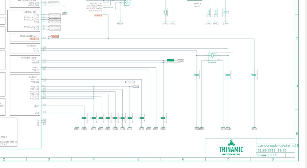

zhangyoubao
We copy the Trinamic's Landungsbruecke(attached Landungsbruecke_v12_01_Schematic.pdf) for our customized design(attached OurCustomizedDesignForMK20DX256VMC10.pdf).
When powered on, the crystal on Trinamic's board works properly, and we can see the oscillating wave.
However, for our customized board, when powered on, the crystal does not work. there is no oscillating wave on EXTAL0 pin.
The schematic is almost the same, and the difference is that: the chip on Trinamic's board is MK20DX256VLL10(100 LQFP package), and the chip on our customized board is MK20DX256VMC10(121 MAPBGA package).
We verified that:
1. Our crystal is OK. We put our crystal on Trinamic's board, and it works properly;
2. The voltages (3.3V and 5V ) are OK. We think that we powered the ARM chip correctly;
3. We tried different load capacitor for the crystal (The crystal requires 8pF load capacitor, we tried 10pF and 15pF, respectively), no work;
4. We have carefully checked our schematic and PCB layout.
Any ideas are appreciated.

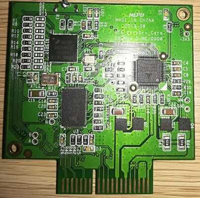

zhangyoubao
@myke_predko
Hi myke,
We've redesigned the board, and corrected the footprint of MK20DX256VMC10. Now,
1. The bootloader program can be downloaded into the chip through SWD;
2. The RESET signal is normal(OK) with only 100nF capacitor (one side is connected to uC's RESET pin, the other side to GND); The reset chip MAX809STRG does not work as expected, but it is not the main problem at present, and we can leave it later to investigate.
Our main issue is that the crystal(PN: FC3BACBDI16.0-T3) is still not working. So, although the bootloader program is downloaded into the chip, the CPU refuse to run without the working crystal. For the load capacitor of the crystal, the recommend value is 8 pF. We have also tried 10 pF and 15 pF, no success.
The schematic for MCU part is attached to this message.
Do you have any ideas?
Thanks.
Youbao

zhangyoubao
Hi myke,
According to your suggestions, we've done the following test:
1. Pull Reset Up High with a 100k pull up resistor to ensure that it is correct. We've monitored the reset signal, and we think it is OK. No success.
2. Put 1M load resistor across the Crystal terminals. No success.
3. Try another crystal. For this, we've actually solder 3 boards. It is equivalent to try another crystal(the same part number). We just do not have crystals with different part number. No success.
We've double checked our schematic and PCB layout, and found no errors. We think that everything is fine, but the crystal just refuse to work. At present, we have no clues for the problem.
To provide more information, we've shared a few files attached to this message.
Youbao

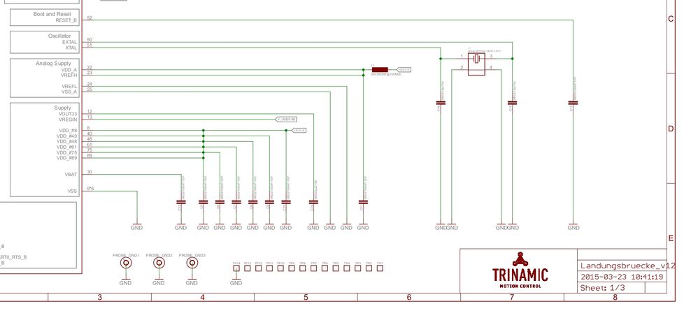

zhangyoubao@siom.ac.cn‌,
You're going to have to hammer at Trinamic to get a straight answer on what's going on here.  The published documentation doesn't match what they're saying and Segger JFlash is a software program - it's not an actual physical programmer with wires going in and out of it.
When I look at the schematics (version 1.2) that you posted in your original email "RESET_B" is simply tied to a cap to ground (very bad practice, BTW):

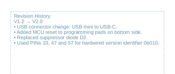

This didn't make sense so I went back to the Trinamic's website and the documents for the Landungsbruecke board, noticed that you had posted version 1.2 and there was version 2.0 files available and when I looked at the schematics, on the first page I saw the added note (look at the second bullet point):
I then looked at RESET_B on the version 2.0 schematics and lo and behold the reset line looks like it's going somewhere else:
But, I can't find any reference to this pad on the the programming pads in the schematic nor do I see anything referencing it on the bottom of the PCB.  If I look at the bottom PCB layer there looks like there are four programming pins on the bottom of the board that I guess are going here but I haven't seen any reference to it in the documentation I've read.

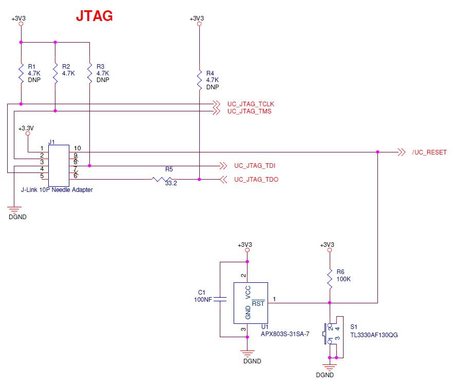

46,709 Views
myke_predko
Senior Contributor III
Hi zhangyoubao@siom.ac.cn‌,
Man, getting that information was like pulling teeth.  I guess if you're not going to buy a bunch of Trinamac's boards, they're really not going to help you.  For an "Open source" company, they have a lot of information that's not available.
With the Segger Interface Description link, I would say that you have enough.  But, I would I would probably suggest that you use a full JTAG programming interface which means:
  • You'll have to reallocate the two LEDs to other pins.  This will require a minor Trinamac Bootloader source code change but as, I believe, that you're using a part with more IO, this shouldn't be an issue.
  • You'll have to add a JTAG connector to your board.
    • Can I suggest using the Segger J-Link Needle Adapter?  This is built into the PCB (and you're respinning it anyway) and does not require any hardware.  I've been using it for a few years now and I really like it.
  • I would recommend putting a pull up and voltage supervisor on _Reset.  Costs a bit more than a chip cap but it buys you a lot of peace of mind.
  • Leave EZP_CS_p (aka PTA4) floating.  I don't like the way Trinamac drives it from VBUS ("V_USB" on their schematics) through a voltage divider (which provides 4V which is higher than VDD's 3.3V which is bad practice).  If you feel you need to drive EZP_CS_b high or low, put in pads for a Zero Ohm resistor to tie the line to Vdd or Vss.
    • I think the purpose of the voltage divider on EZP_CS_b (PTA4) is for a USB detect - if this function is still required, then add a voltage divider (which produces a max of 3.3V) to VBUS and put this on another input pin.
Here is the programming/reset circuit that I'm currently working with (just to show you that I put my money where my mouth is):
Let me know if you have any other questions,
myke

Hi Myke,
I will follow your recommendation for the _Reset connections.
But a full JTAG programming interface would take a comparative space on the quite compact board. Following are the front side and the back side of my board. I would use the SWD approach for programming this time, and I will take your suggestion for my next board design.
Thank you for your continuously patiently coaching!
Youbao
