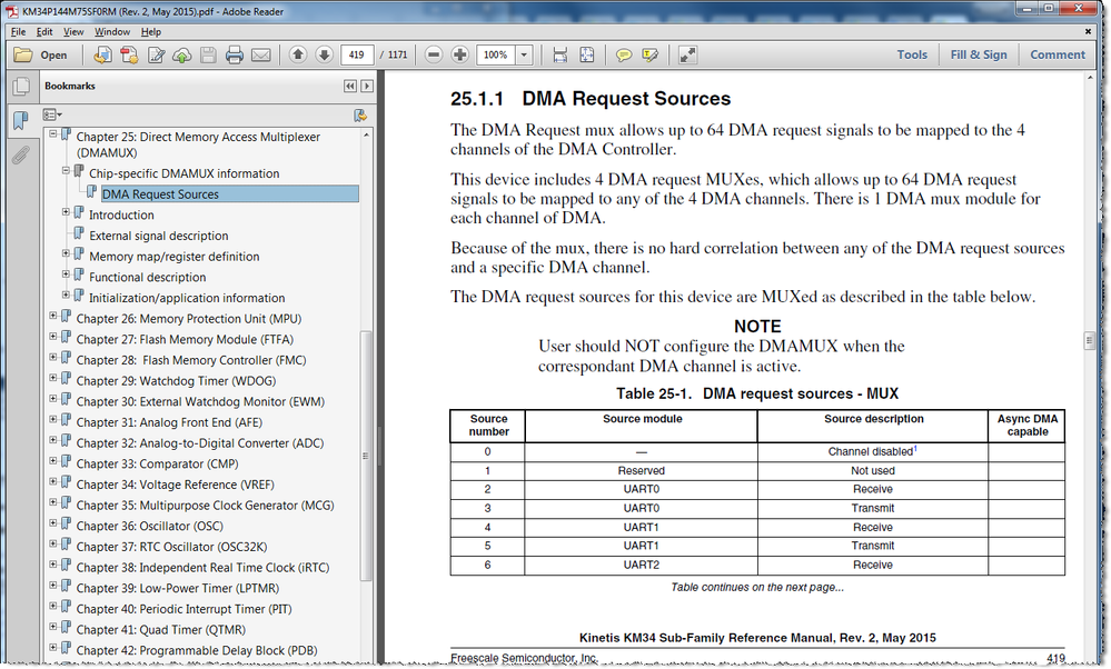

Can the UART of KM34 work in the DMA mode? If yes, is there any example?

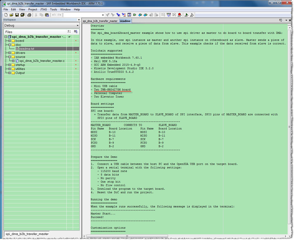

I have used the example "C:\Freescale\SDK_2.0_TWR-KM34Z75M\boards\twrkm34z75m\driver_examples\spi\dma_b2b_transfer\master\iar\spi_dma_b2b_transfer_master.eww" .But the communication result is not successful.What is the reason?
3,164 Views
Robin_Shen
Would you please tell us what kind of error you have meet?
I have only one TWR-KM34Z75M, so I don't have another spi instance on othereboard as slave.

小勇邹
Thank you for your help.The error happens because I have not connected the slave.

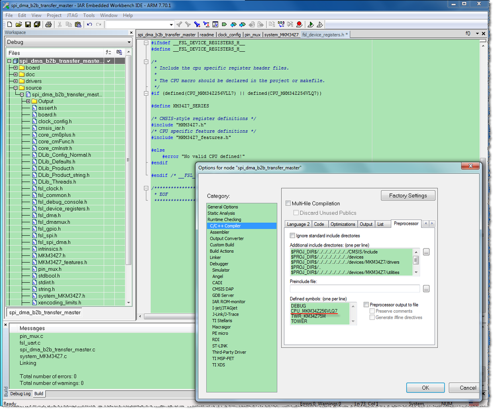

I transplant the DMA source code to my old project.
There is an error  "No valid CPU defined!" in the file fsl_device_registers.h after the compiling in the my old IAR project.
It happens because I have not define the CPU_MKM34Z256VLL7 and CPU_MKM34Z256VLQ7.
I cannot find where to define CPU_MKM34Z256VLL7 and CPU_MKM34Z256VLQ7 in the example.
Can you tell me where to define the CPU_MKM34Z256VLL7 and CPU_MKM34Z256VLQ7?
3,164 Views
Robin_Shen
You can find it in the Defined symbols:
Robin

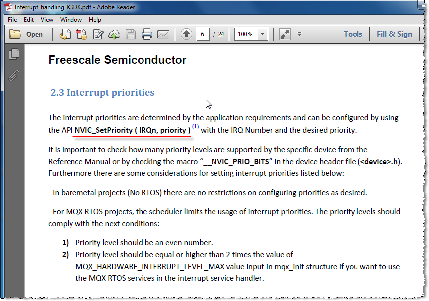

How to set the priority level of the “DMA channel transfer complete interrupt”? I cannot find it in the example.
3,164 Views
Robin_Shen
Please use the API NVIC_SetPriority ( IRQn, priority ).
"Interrupt_handling_KSDK.pdf" can be download from Interrupt handling with KSDK and Kinetis Design Studio.

Yes. The UART of KM34 can work in the DMA mode.
Please check the chapter "25.1.1 DMA Request Sources" and "45.8 DMA operation" in KM34P144M75SF0RM.

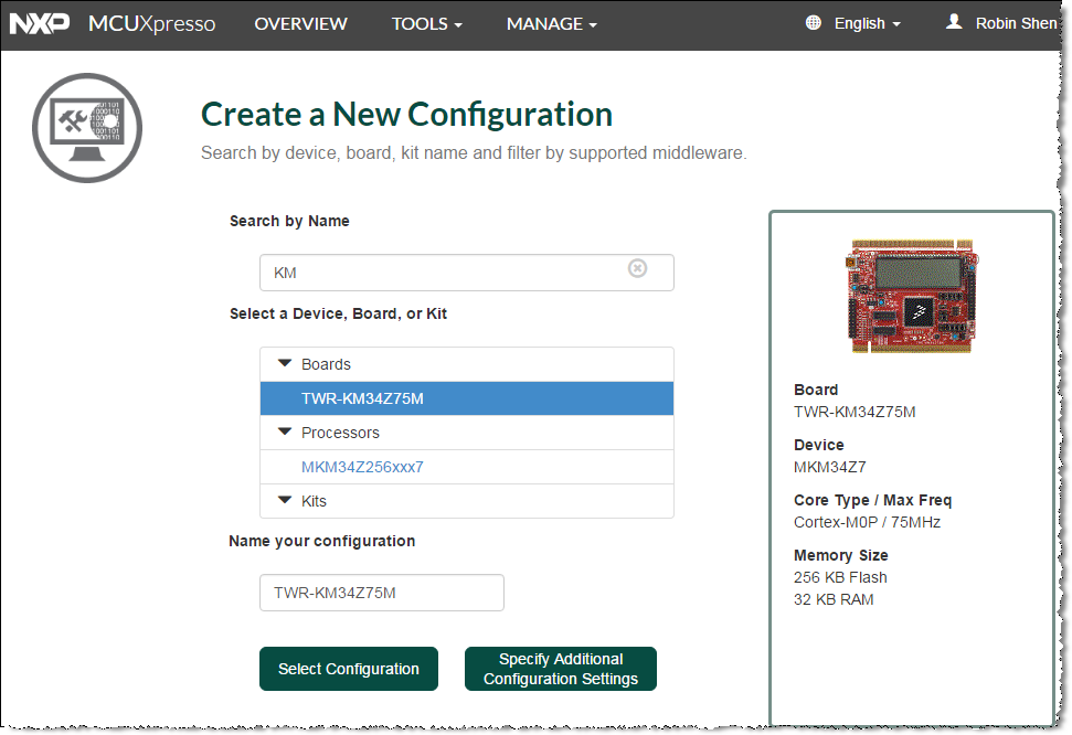

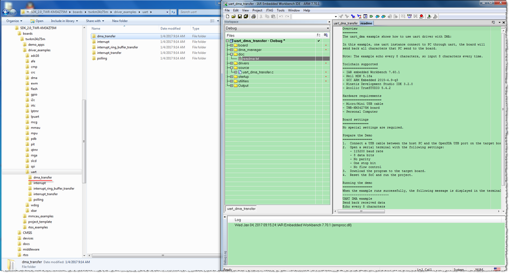

You can refer the example "dma_transfer" in KINETIS-SDK.

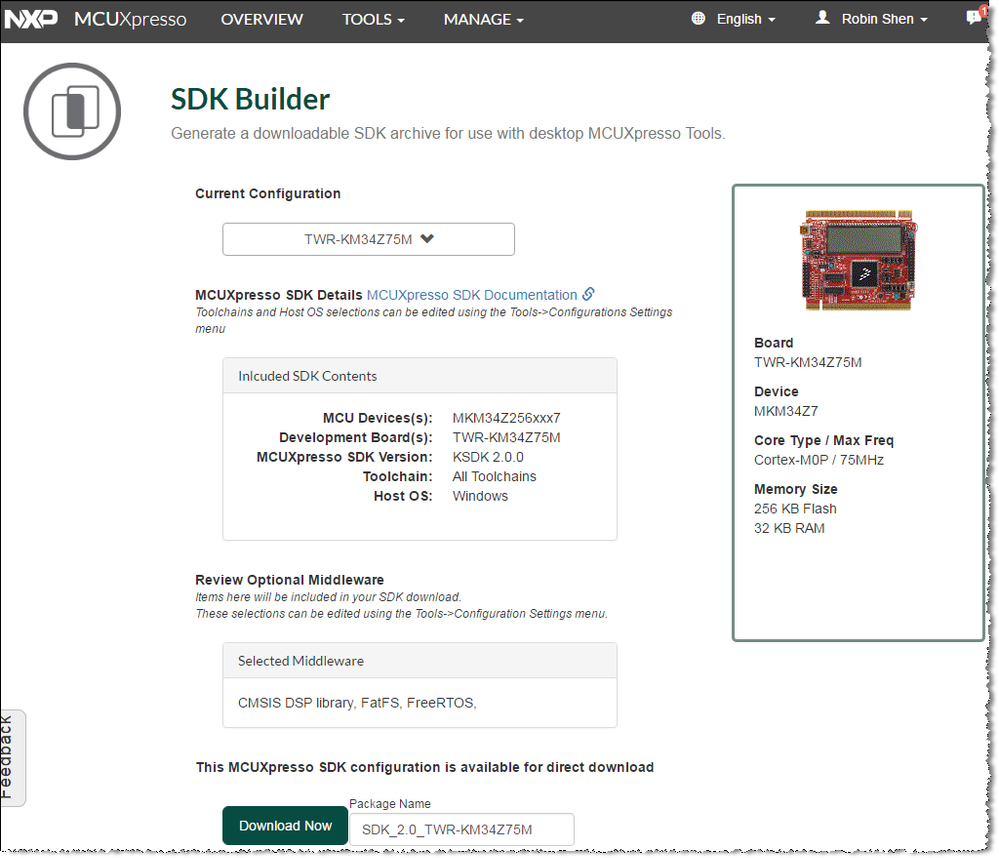

Please search KM34 then select TWR-KM34Z75M and download SDK_2.0_TWR-KM34Z75M.
