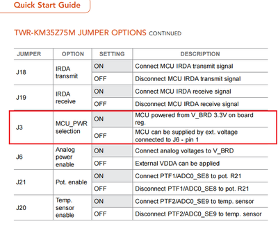

Do you mean there is a discrepancy between our reference board and the schematic diagram? Or is it your custom board that has this issue?
Is the setting of your Jumper J3 correct?

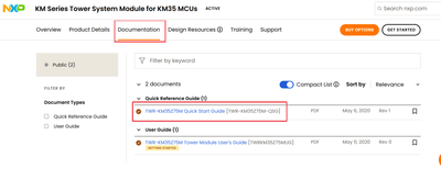

Please refer to the TWR-KM35Z75M-QSG.
The doc can be downloaded from TWR-KM35Z75M | Tower System Board | KM MCUs | NXP | NXP Semiconductors
Hope it can help you.
