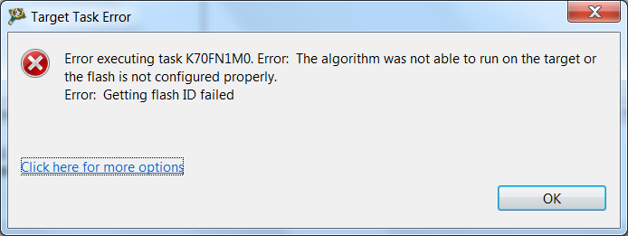

With the P&E linled to the JTAG  on the board, whenI try to do a "Flash file to target" -> "Erase whole device", following error occurs:
The Console write following:
fl::target -lc "LC for Simple Flash (2)"
fl::target -b 0x1fff0000 0x20000
fl::target -v off -l off
cmdwin::fl::device -d "FTFE_PFlash1M0" -o "128Kx64x1" -a 0x0 0xfffff
cmdwin::fl::erase all
Beginning Operation ...
Performing target initialization ...
Downloading Flash Device Driver ...
Reading flash ID .......
Error: The algorithm was not able to run on the target or the flash is not configured properly.
Error:  Getting flash ID failed

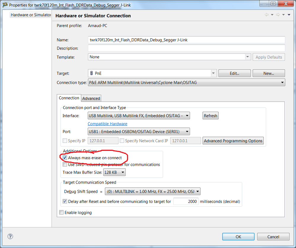

To return to the subject of this post, my problem was a problem to program a basic program (in internal flash) following my try to program the external flash which had failed.
All simple programs like "hello" I tried failed in programing. Error message was presented in my first post.
My collegue found how to resolve my problem.
Just need to tick the following option at least one time. After that, the programing works again.

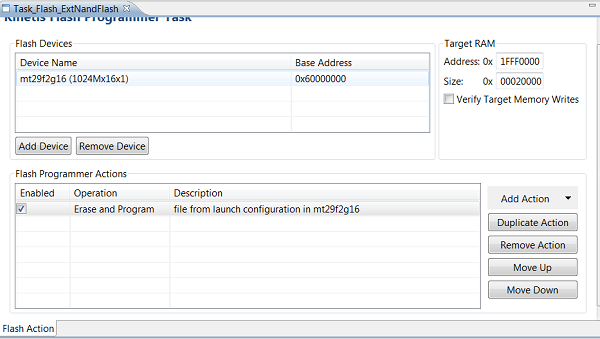

So If I well  understand, I had a target task like following:
and then in Debug Configuration\ Debugger I add the target task created.

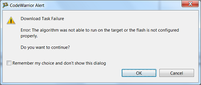

I start the debug, but loading failed with following message in the console:
Executing download task: {----MyWorkspace---}\build-twrk70n1m-cw-mqx-d\cw10\Task_Flash_ExtNandFlash.tcl
cmdwin::fl::target -lc hellopeg twrk70f120m_IntFlash_DDRData
cmdwin::fl::target -b 0x1fff0000 0x20000
cmdwin::fl::target -v off -l off
cmdwin::fl::device -d mt29f2g16 -o 1024Mx16x1 -a 0x60000000 0x6fffffff
cmdwin::fl::image -f  {----MyWorkspace---}\build-twrk70n1m-cw-mqx-d\cw10\twrk70f120m_I
nt_Flash_DDRData_Debug\hellopeg.afx -t Auto Detect -re off -oe off
cmdwin::fl::erase image
Auto-detection is successful.
  File is of type Elf Format.
<e>Error: The algorithm was not able to run on the target or the flash is not configured properly. </e>
<e>Error: Getting flash ID failed </e>
An invalid preference was passed to the GDI protocol plugin(ARM GDI Protocol Adapter)
